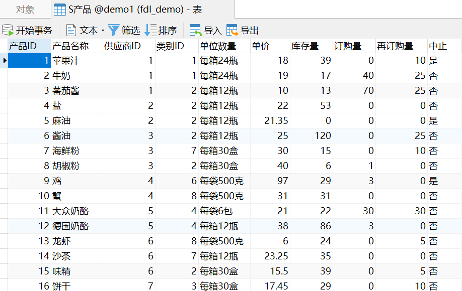

    There is a data table named Product in the demo1 database. You intend to synchronize the data where Category_ID = 2 to the demotest database.
    Implementation Method
    In the Product table, Product_ID is the primary key. First, you need to retrieve the Product_ID values of the data where Category_ID = 2 and set them as parameters; then, you can use these parameters in downstream data synchronization to synchronize the data that meets the criteria to the target database.

    2. Retrieve the Product_ID values of the data where Category_ID = 2 and set them as parameters, as shown in the following figure.
    SQL Statement:
    SELECT Product_ID from `demo1`.`Product`
    where Category_ID=2
    Click Data Preview to see the extracted Product_ID values of data where Category_ID = 2, as shown in the following figure.
