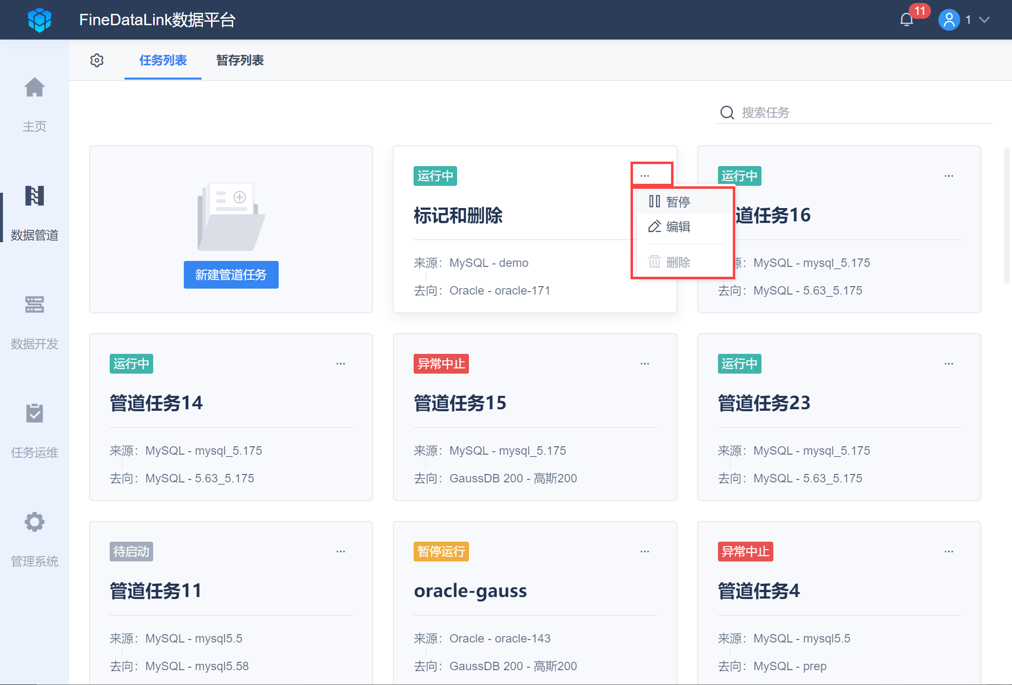

    If you are using the Data Pipeline function, pause the running synchronization tasks before configuring the external database.

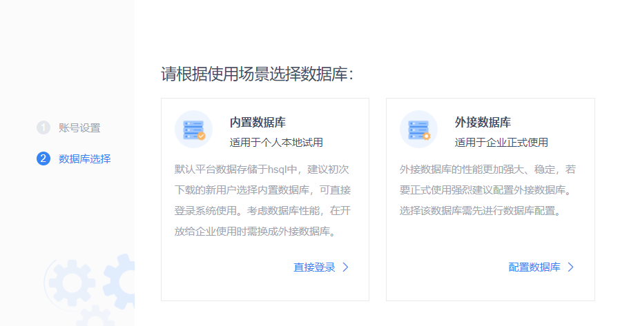

    1. You (the super admin) can configure an external database for the system upon first login, as shown in the following figure.

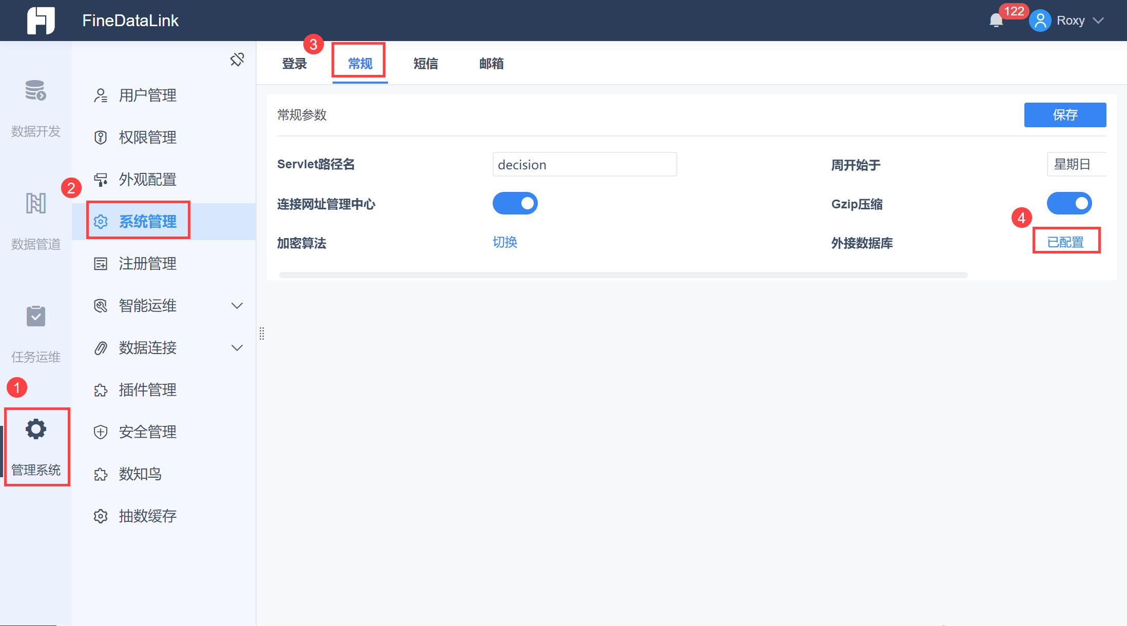

    2. For systems that use built-in databases, you (the super admin) can log in to the system, choose System Management > System Setting > General > External Database > To Be Configured, and configure the external database for the system for the first time, as shown in the following figure.
    3. For systems for which external databases have been enabled, you (the super admin) can log in to the system, choose System Management > System Setting > General > External Database > Configured, and migrate data to a new external database for the system, as shown in the following figure.

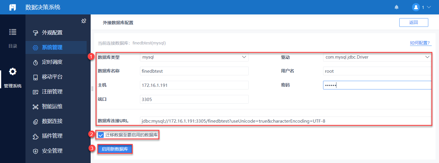

    Configuring the External Database
    After you access the external database configuration page, select the database type and enter the information of the actual database, as shown in the following figure.

    Migrating Data to the Database to Be Enabled
    You can determine whether to tick Migrate Data to Database to Be Enabled as needed. The following describes the details:
    1. If the new external database is empty, and Migrate Data to Database to Be Enabled is ticked:
    After you click Enable New Database, the platform data of the original FineDB database will be migrated to the new external database.
    2. If the platform data already exists in the new external database, and Migrate Data to Database to Be Enabled is ticked:
    After you click Enable New Database, the message "The platform data already exists in the database. Before data import, the original platform data will be cleared. Sure to connect to the database?" pops up.
    After you click OK, the original platform data will be cleared, and the platform data of the original FineDB database will be migrated to the new external database.
    3. If the new external database is empty, and Migrate Data to Database to Be Enabled is unticked:
    After you click Enable New Database, the message "The target database is a new database and can be used after the current data is migrated to the target database." pops up.
    After you click OK, the platform data of the original FineDB database will be migrated to the new external database.

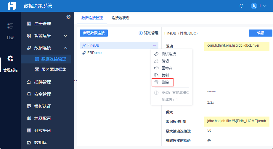

    Deleting the Data Connection to the Built-in Database
    The built-in FineDB database is an HSQL database that creates an in-memory database when used, which will occupy a large amount of memory when the data volume is large.
    Therefore, after configuring the external database, check whether a data connection to the built-in FineDB database exists in Data Connection.
    If so, delete the data connection in time. Otherwise, the connection will continue to occupy server memory.
