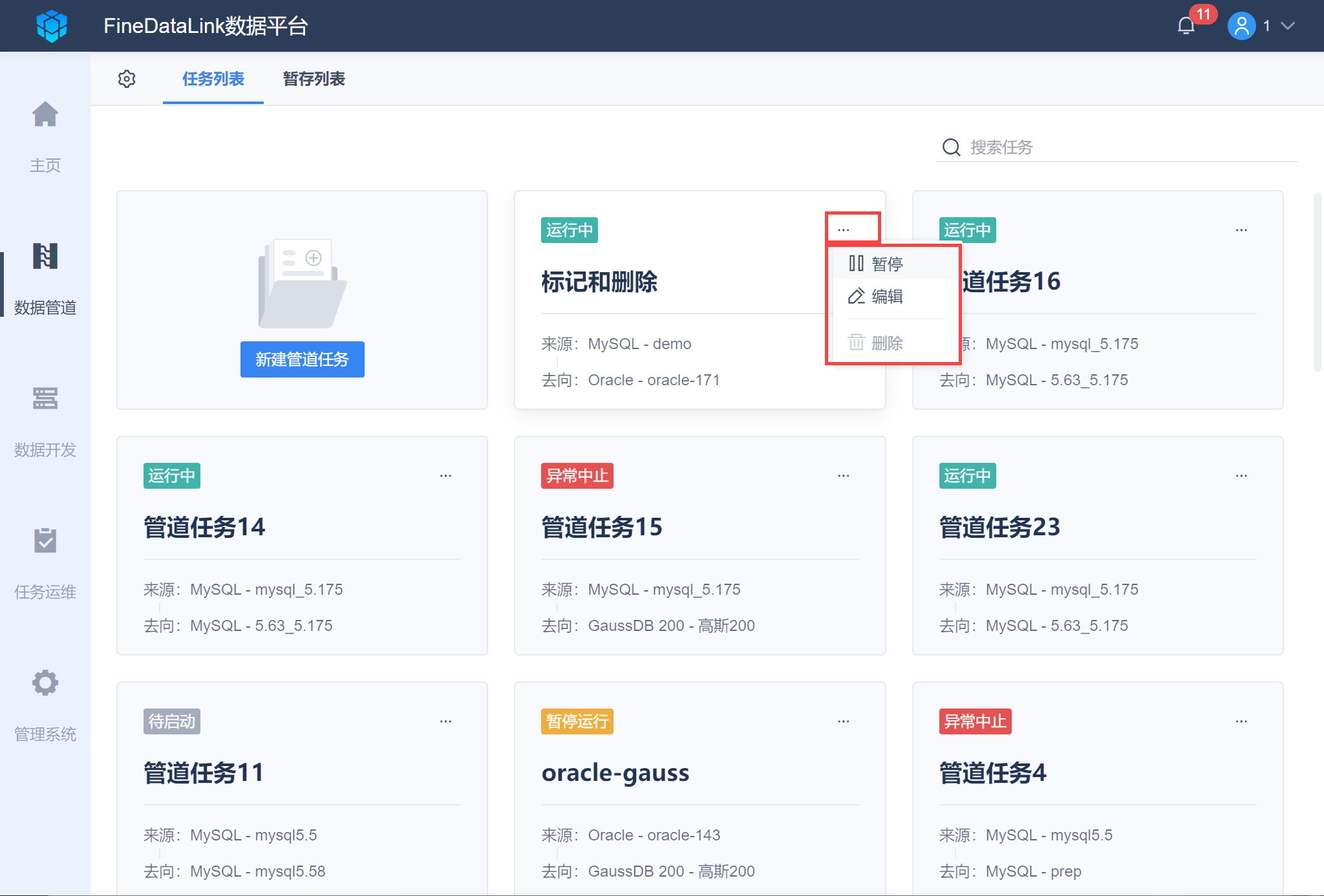

    If you are using the Data Pipeline function, pause the running synchronization tasks before configuring the external database.

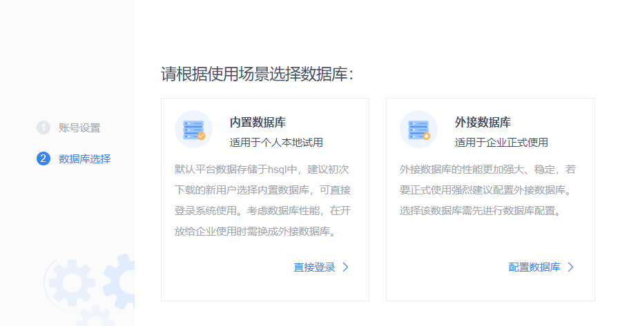

    1. You (the super admin) can configure an external database for the system upon first login, as shown in the following figure.

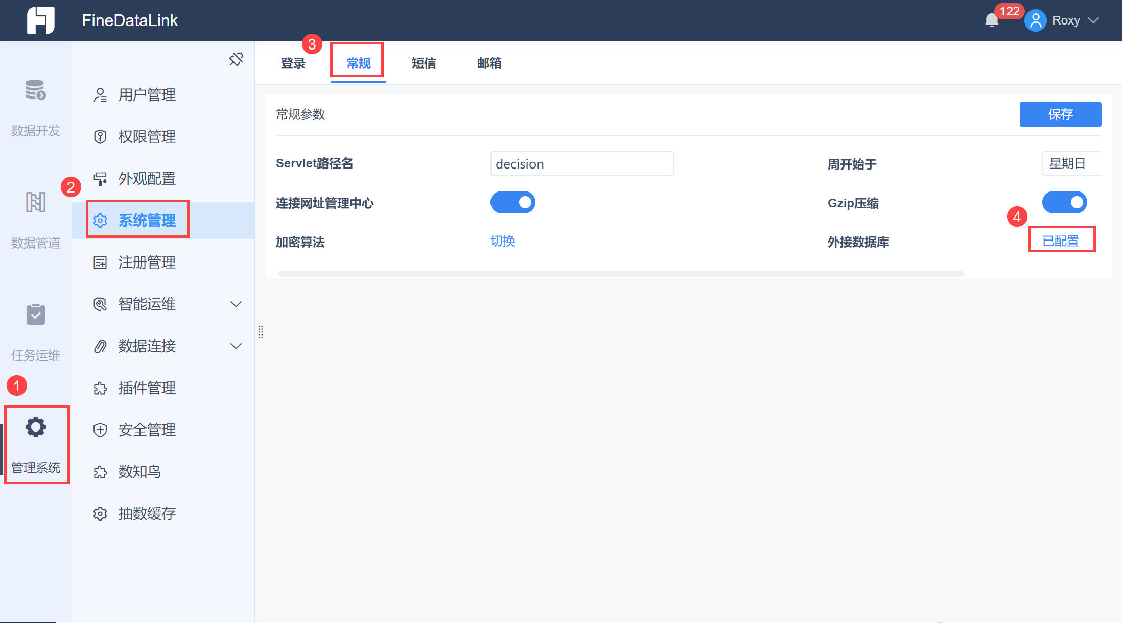

    3. For systems for which external databases have been enabled, you (the super admin) can log in to the system, choose System Management > System Setting > General > External Database > Configured, and migrate data to a new external database for the system, as shown in the following figure.

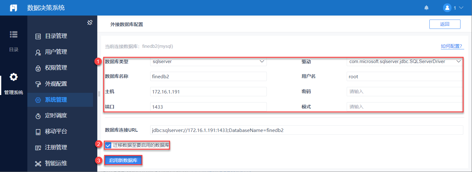

    Configuring the External Database
    After you access the external database configuration page, select the database type and enter the information of the actual database, as shown in the following figure.
    Setting Item
    The following table describes each setting item.
    Setting ItemDescription
    Database type
    Select sqlserver.
    Driver
    This parameter is automatically configured, requiring no modification.
    Database name
    Enter the name of the database created in the "Creating a Database" section.
    iconNotes:
    Sharing a database with other projects is prohibited. You are advised to create a database.
    The database name can contain only numbers, letters, underscores (_), and periods (.).
    Username/Host/Password/Port
    Enter these values based on the actual database configuration.
    iconNote:
    The hostname can contain only numbers, letters, underscores (_), hyphens (-), and periods (.).
    Mode
    You can select a mode from the drop-down list.

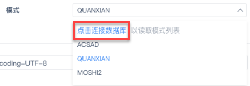

    After correctly setting the values of the above parameters, select Click to Connect Database from the drop-down list. The system will automatically connect to the database and read schemas. Select a schema (preferably the one matching the database username).
    iconNote:
    If a prompt indicating database connection failure is displayed, check the settings above.

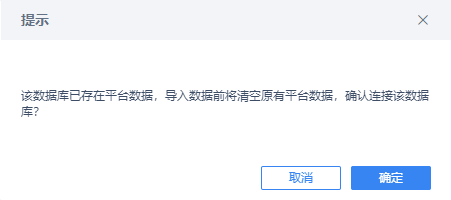

    2. If the platform data already exists in the new external database, and Migrate Data to Database to Be Enabled is ticked:
    After you click Enable New Database, the message "The platform data already exists in the database. Before data import, the original platform data will be cleared. Sure to connect to the database?" pops up.
    After you click OK, the original platform data will be cleared, and the platform data of the original FineDB database will be migrated to the new external database.

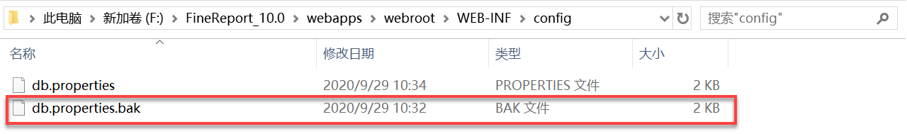

    • If the JAR package versions are consistent and the original FineDB database is an external database, the system automatically backs up the original database configuration before migration, generates a db.properties.bak file in webapps/webroot/WEB-INF/config, and enables the new external database, as shown in the following figure.

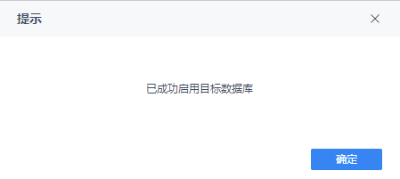

    1. If the new external database uses data from the original FineDB database:
    The message "The target database has been enabled successfully." pops up. Click OK to complete the migration, as shown in the following figure.

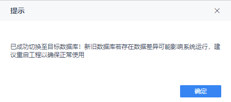

    2. If the new external database uses its own existing data and the original FineDB database is a built-in database:
    The message "Successfully switched to the target database. If data is different between the old and new databases, system running may be affected. You are advised to restart the project for normal use." pops up.
    Click OK and restart the project to complete the migration, as shown in the following figure.
