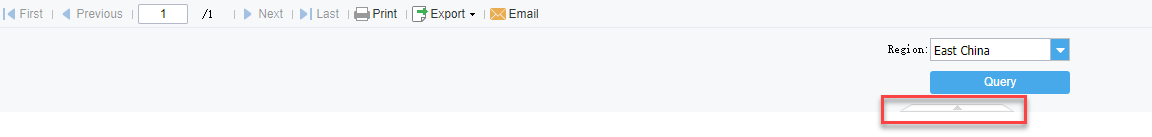

    When previewing a template with a parameter pane, there will be a triangle button at the junction between the parameter pane and the home interface. How to hide this triangle button?

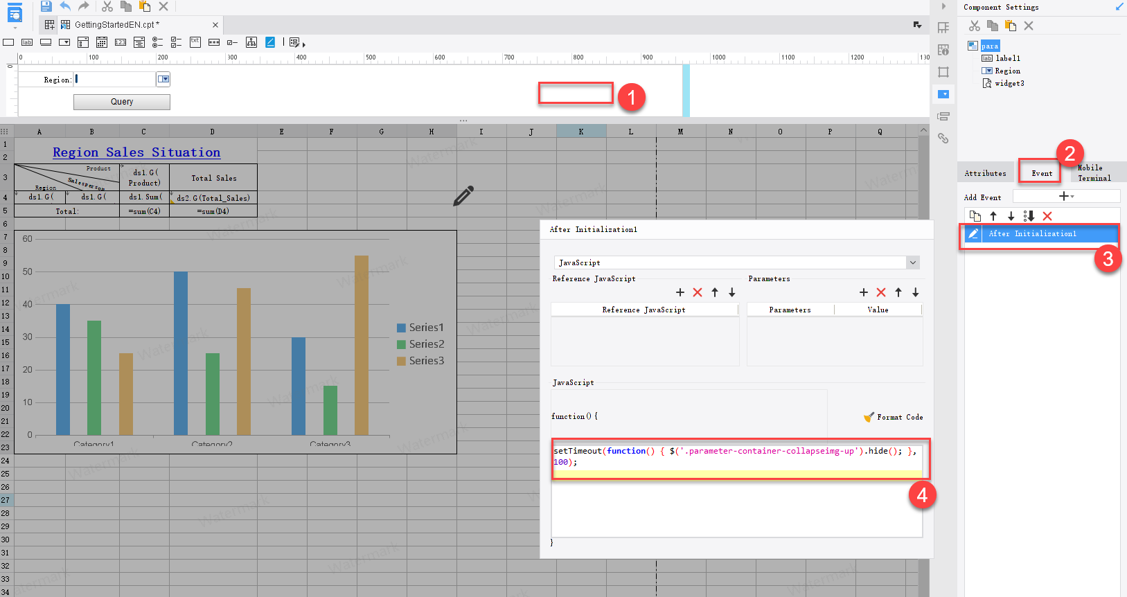

    1)Open the Designer and double-click the template to switch to the Edit Parameter Interface. Click on a bland area on the pane and add an After Initialization event.
    Input the following JavaScript codes:
    setTimeout(function() { $('.parameter-container-collapseimg-up').hide(); }, 100);
    2)Save the template and click [Preview]. You will find the triangle button is hidden. See the demonstration above.

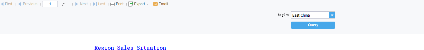

    2.2 Preview
    Save the template and click [Pagination Preview]. The preview effect on a PC is shown as below:
