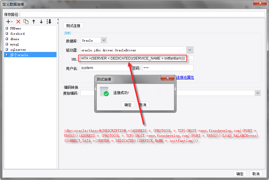

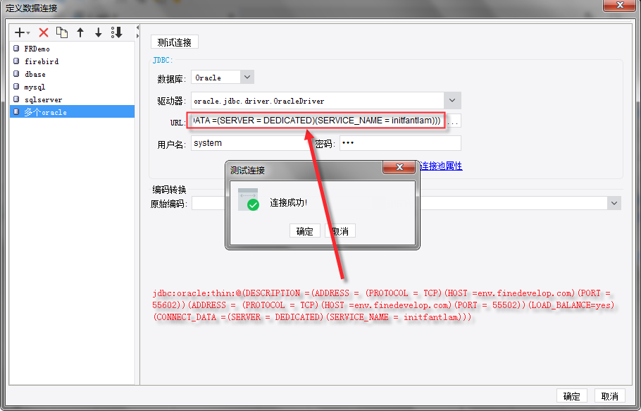

示例2:在env.finedevelop.com对应55602端口拥有一个数据库initfantlam,同时对应55502端口也拥有一个数据库initfantlam,那么数据库连接的url就改成:
jdbc:oracle:thin:@(DESCRIPTION =(ADDRESS = (PROTOCOL = TCP)(HOST =env.finedevelop.com)(PORT = 55602))(ADDRESS = (PROTOCOL = TCP)(HOST =env.finedevelop.com)(PORT = 55502))(LOAD_BALANCE=yes)(CONNECT_DATA =(SERVER = DEDICATED)(SERVICE_NAME = initfantlam)))即可。
