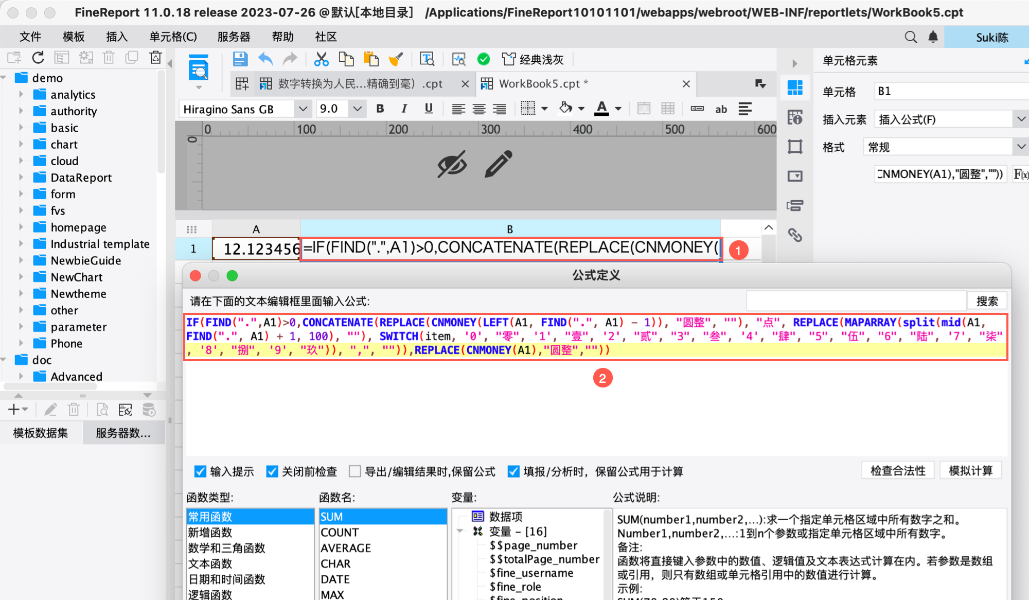

1)新建一张普通报表,右击任意单元格(例如 A1 单元格),输入数值1234.123,如下图所示:
2)选中 B1 单元格,输入公式:IF(FIND(".",A1)>0,CONCATENATE(REPLACE(CNMONEY(LEFT(A1, FIND(".", A1) - 1)), "圆整", ""), "点", REPLACE(MAPARRAY(split(mid(A1, FIND(".", A1) + 1, 100), ""), SWITCH(item, '0', "零", '1', "壹", '2', "贰", "3", "叁", '4', "肆", "5", "伍", "6", "陆", '7', "柒", '8', "捌", '9', "玖")), ",", "")),REPLACE(CNMONEY(A1),"圆整",""))
,如下图所示:
公式说明:
公式说明
FIND(".",A1)>0是否存在小数
若存在小数,小数点左边部分通过函数 CNMONEY() 直接转换为中文
REPLACE(MAPARRAY(split(mid(A1, FIND(".", A1) + 1, 100), ""), SWITCH(item, '0', "零", '1', "壹", '2', "贰", "3", "叁", '4', "肆", "5", "伍", "6", "陆", '7', "柒", '8', "捌", '9', "玖")), ",", "")右边部分通过函数 MAPARRAY() 将具体每一位数字转换成杜对应的大写中文字符
CONCATENATE(REPLACE(CNMONEY(LEFT(A1, FIND(".", A1) - 1)), "圆整", ""), "点", REPLACE(MAPARRAY(split(mid(A1, FIND(".", A1) + 1, 100), ""), SWITCH(item, '0', "零", '1', "壹", '2', "贰", "3", "叁", '4', "肆", "5", "伍", "6", "陆", '7', "柒", '8', "捌", '9', "玖")), ",", ""))左右结果通过函数 CONCATENATE()拼接起来
REPLACE(CNMONEY(A1),"圆整","")若不存在小数,直接通过函数 CNMONEY() 转换为中文,并去掉人民币单位即可

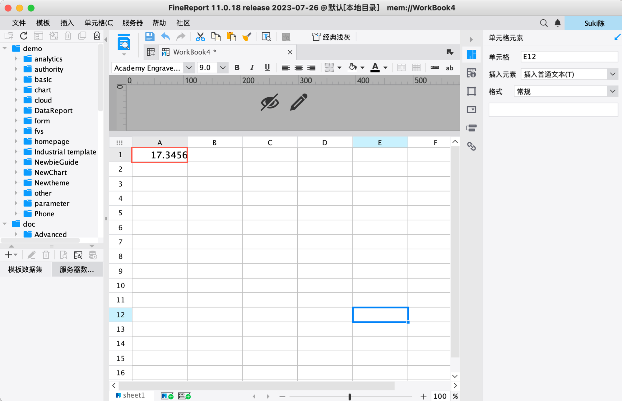

1)新建一张普通报表,选中任意单元格(例如 A1 单元格),输入数值17.3456,如下图所示:

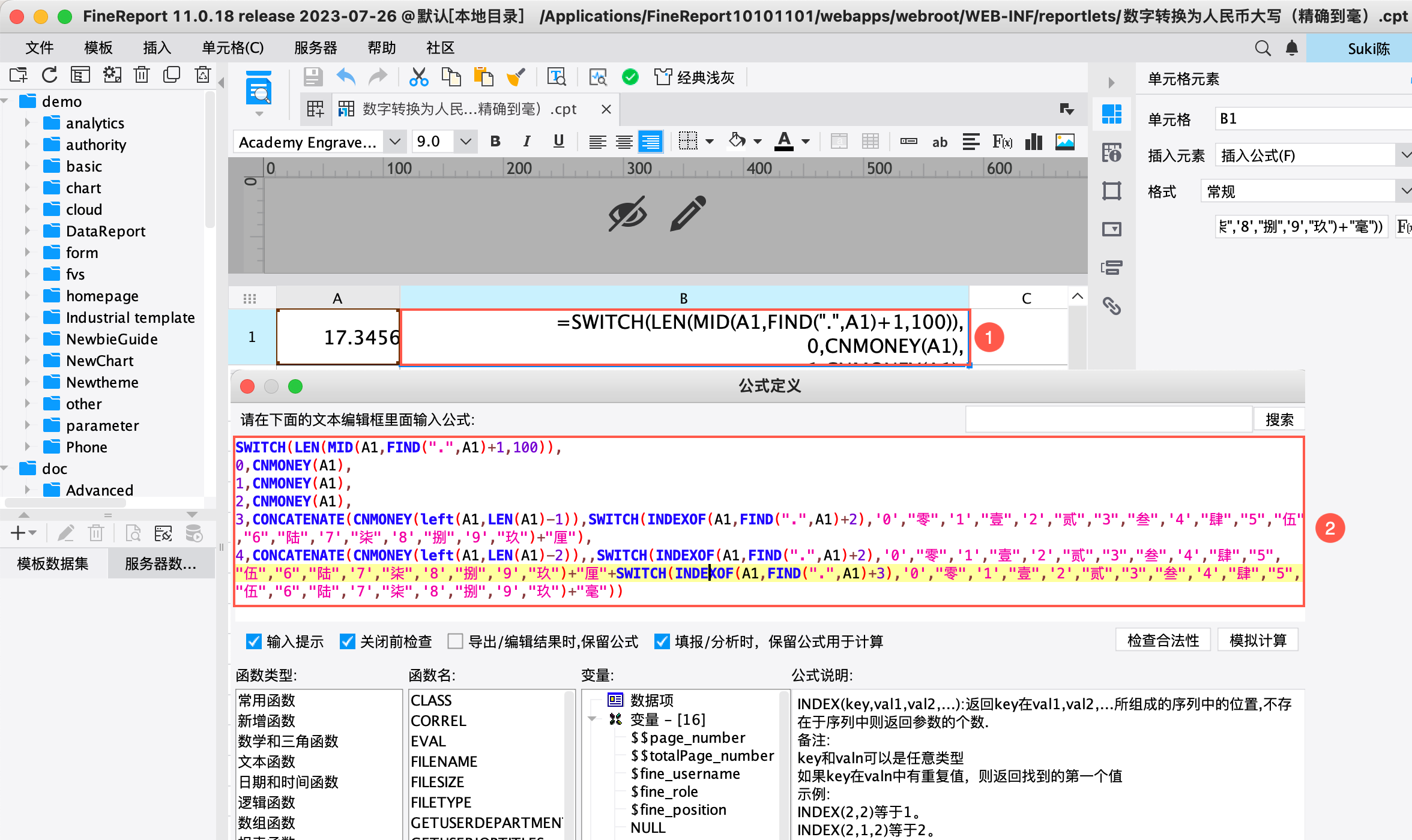

2)选中 B1 单元格,输入公式:SWITCH(LEN(MID(A1,FIND(".",A1)+1,100)),0,CNMONEY(A1),1,CNMONEY(A1),2,CNMONEY(A1),3,CONCATENATE(CNMONEY(left(A1,LEN(A1)-1)),SWITCH(INDEXOF(A1,
FIND(".",A1)+2),'0',"零",'1',"壹",'2',"贰","3","叁",'4',"肆","5","伍","6","陆",'7',"柒",'8',"捌",'9',"玖")+"厘"),4,CONCATENATE(CNMONEY(left(A1,LEN(A1)-2)),,SWITCH(INDEXOF(A1,
FIND(".",A1)+2),'0',"零",'1',"壹",'2',"贰","3","叁",'4',"肆","5","伍","6","陆",'7',"柒",'8',"捌",'9',"玖")+"厘"+SWITCH(INDEXOF(A1,FIND(".",A1)+3),'0',"零",'1',"壹",'2',"贰","3","叁",'4',"肆",
"5","伍","6","陆",'7',"柒",'8',"捌",'9',"玖")+"毫"))
,如下图所示:
公式说明如下:
注:在使用 Cnmoney函数 时,若小数位超过两位(精度超过分),Cnmoney 函数会对数字四舍五入后再转人名币大写。
公式说明
判断小数部分的位数(精度)
为防止 Cnmoney 函数四舍五入,仅取出精度范围内的部分进行转换
SWITCH(INDEXOF(A1,FIND(".",A1)+2),'0',"零",'1',"壹",'2',"贰","3","叁",'4',"肆","5","伍","6","陆",'7',"柒",'8',"捌",'9',"玖")+"厘")
精度外的部分通过 Switch 函数进行转换:
  • 先通过 INDEXOF 函数取出小数点后第三位(厘)上的数字
  • 通过 SWITCH 函数将数字转大写,并加上单位「厘」
CONCATENATE(CNMONEY(left(A1,LEN(A1)-1)),SWITCH(INDEXOF(A1,FIND(".",A1)+2),'0',"零",'1',"壹",'2',"贰","3","叁",'4',"肆","5","伍","6","陆",'7',"柒",'8',"捌",'9',"玖")+"厘")
通过 CONCATENATE 函数将以上两步转换后的内容拼接在一
CONCATENATE(CNMONEY(left(A1,LEN(A1)-2)),,SWITCH(INDEXOF(A1,FIND(".",A1)+2),'0',"零",'1',"壹",'2',"贰","3","叁",'4',"肆","5","伍","6","陆",'7',"柒",'8',"捌",'9',"玖")+"厘"+SWITCH(INDEXOF(A1,FIND(".",A1)+3),'0',"零",'1',"壹",'2',"贰","3","叁",'4',"肆","5","伍","6","陆",'7',"柒",'8',"捌",'9',"玖")+"毫")
同理可将小数第四位(厘)上的数字转换为人民币大写
0,CNMONEY(A1),
1,CNMONEY(A1),
2,CNMONEY(A1),
3,CONCATENATE(CNMONEY(left(A1,LEN(A1)-1)),SWITCH(INDEXOF(A1,FIND(".",A1)+2),'0',"零",'1',"壹",'2',"贰","3","叁",'4',"肆","5","伍","6","陆",'7',"柒",'8',"捌",'9',"玖")+"厘"),
4,CONCATENATE(CNMONEY(left(A1,LEN(A1)-2)),,SWITCH(INDEXOF(A1,FIND(".",A1)+2),'0',"零",'1',"壹",'2',"贰","3","叁",'4',"肆","5","伍","6","陆",'7',"柒",'8',"捌",'9',"玖")+"厘"+SWITCH(INDEXOF(A1,FIND(".",A1)+3),'0',"零",'1',"壹",'2',"贰","3","叁",'4',"肆","5","伍","6","陆",'7',"柒",'8',"捌",'9',"玖")+"毫"))
通过 SWITCH 函数,根据小数部分的位数选择对应的转换方式:
  • 位数为 0~2(即精度最大到分)时,直接通过 CNMONEY 函数转换
  • 位数为 3(厘)需分别对分位、厘位进行转换后,再进行拼接
  • 位数为 4(毫)需分别对分位、厘位、毫位进行转换后,再进行拼接

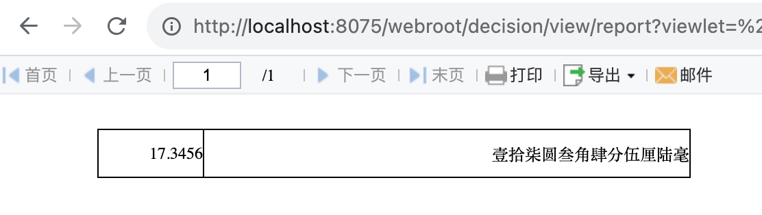

3.2 效果预览
保存模板,选择分页预览,如下图所示:
