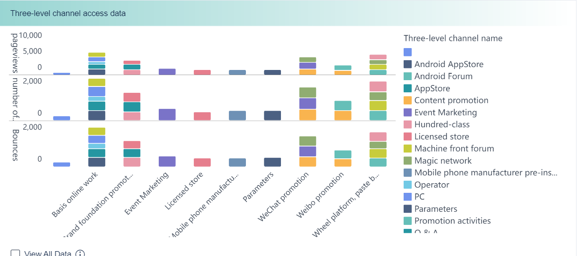

    You can enable stacking for fine-grained display in case of indicator juxtaposition. For example, choose Internet Channel Statistics under My Analysis > Industry Application > Internet, drag Secondary Channel Name to Horizontal Axis, drag Pageviews, Number of Visits, and Bounces to Vertical Axis, and select Indicator Juxtaposition, as shown in the following figure.
    Because the indicators are in juxtaposition and displayed in different coordinate systems, the components are not stacking. If you want to make the secondary channel of the dimension more fine-grained, such as adding the tertiary channel, drag the field Three-level channel name to color in Graphic Property, and you will find that the secondary channel will be divided into tertiary channels with a stacking effect, as shown in the following figure.
    In addition, you can drag the field Three-level channel name to Fine-grained in Graphic Property to achieve a stacking effect without various colors.
