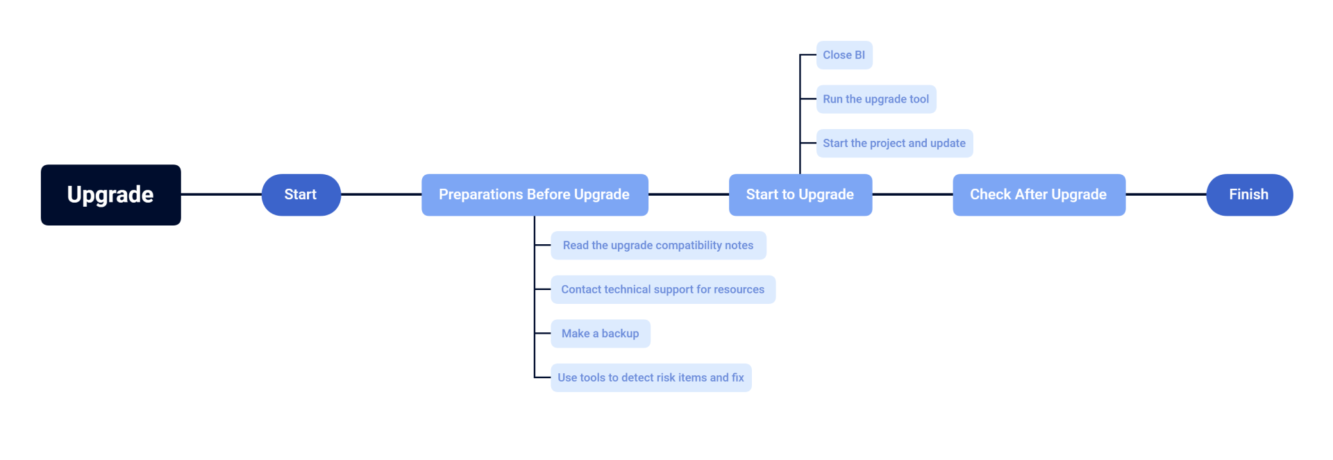

    This tool helps users smoothly upgrade BI project from version 5.1 to 6.0.5.
    Upgrade Process
    Preparation Before Upgrade
    1. Read Version 6.0 Compatibility Description to learn about the changes from version 5.1 to version 6.0.
    2. Backup the 5.1 project, detect and repair upgrade risk items.
    3. You can send an email to international@fanruan.com or click   at https://intl.finebi.com/
