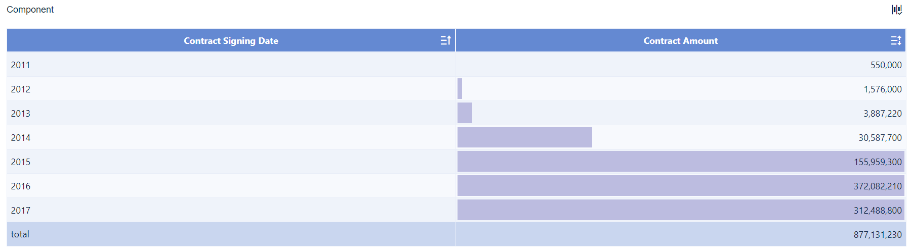

    2. Click the 4efe6ece518183e97ad5a12cc46666b.png button next to the Contract Amount field in Indicator and select Data Bar Setting from the drop-down list to set the data bar.
    1. Setting Max/Min Values
    1. Set Min Value and Max Value to Custom. Enter 600,000 in the input field of Min Value and enter 100,000,000 in the input field of Max Value. (You need to set the maximum value first, otherwise "The maximum value cannot be less than the minimum value" will prompt.)
    2. The following figure shows the effect.
    2. Setting the Value Colors
    1. Set Positive Color to purple. (The table in this example contains only positive values, so only Positive Color is set to purple.)
    3. Setting to Only Show the Data Bar
    1. Check Only Show Data Bar, as shown in the following figure.
    2. The numbers are hidden and only the data bar is displayed, as shown in the following figure.
