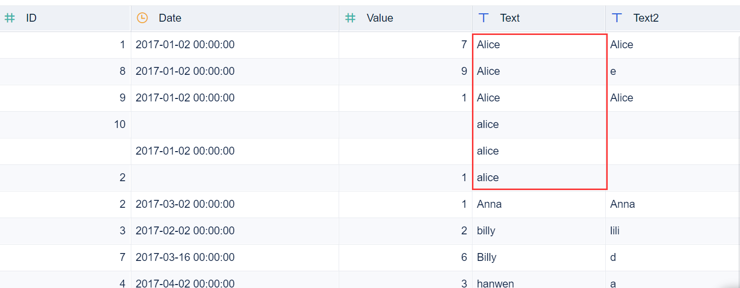

    Some fields with the same meaning in the database differ in terms of uppercase and lowercase letters, such as Alice and alice, as shown in the following figure.
