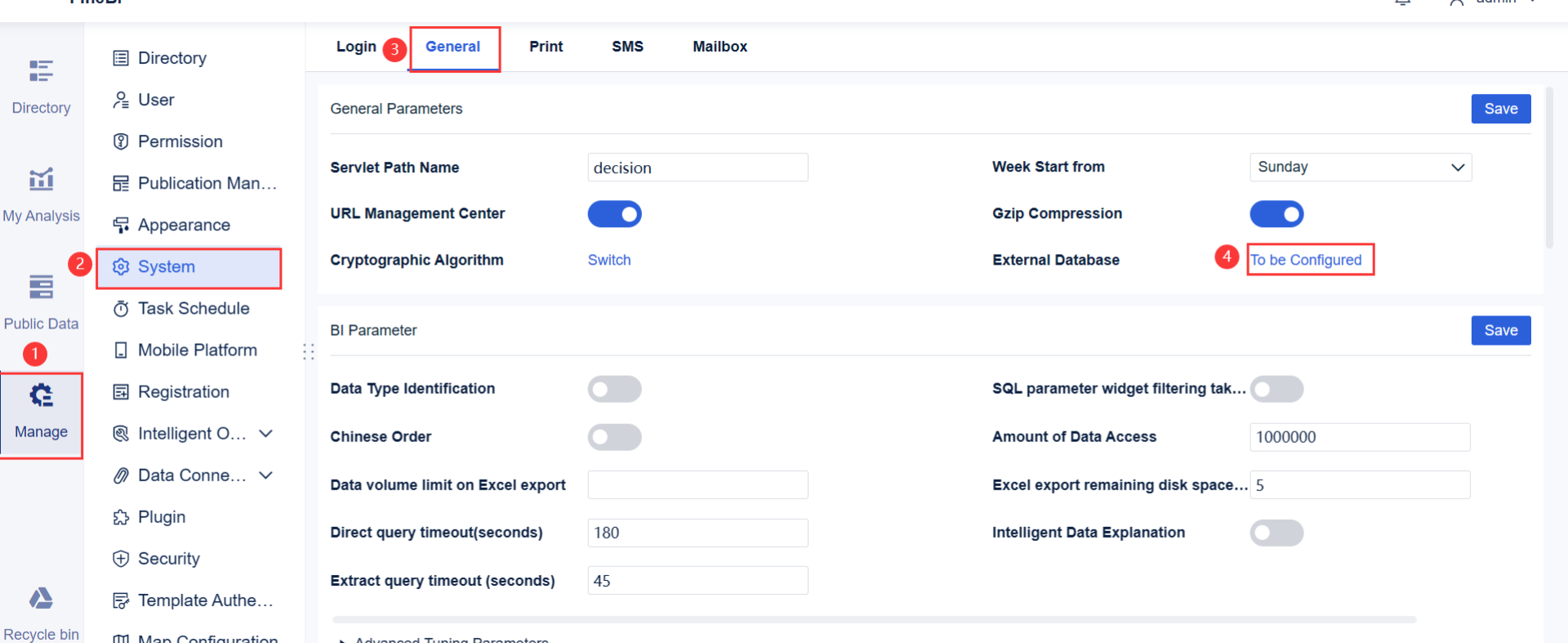

    Confirming Database Type
    To determine whether an external database is configured, go to Manage > System > General.
    • If To be Configured is displayed, it indicates that you are currently using a built-in database.
    • If Configured is displayed, it indicates that an external database is being used.
