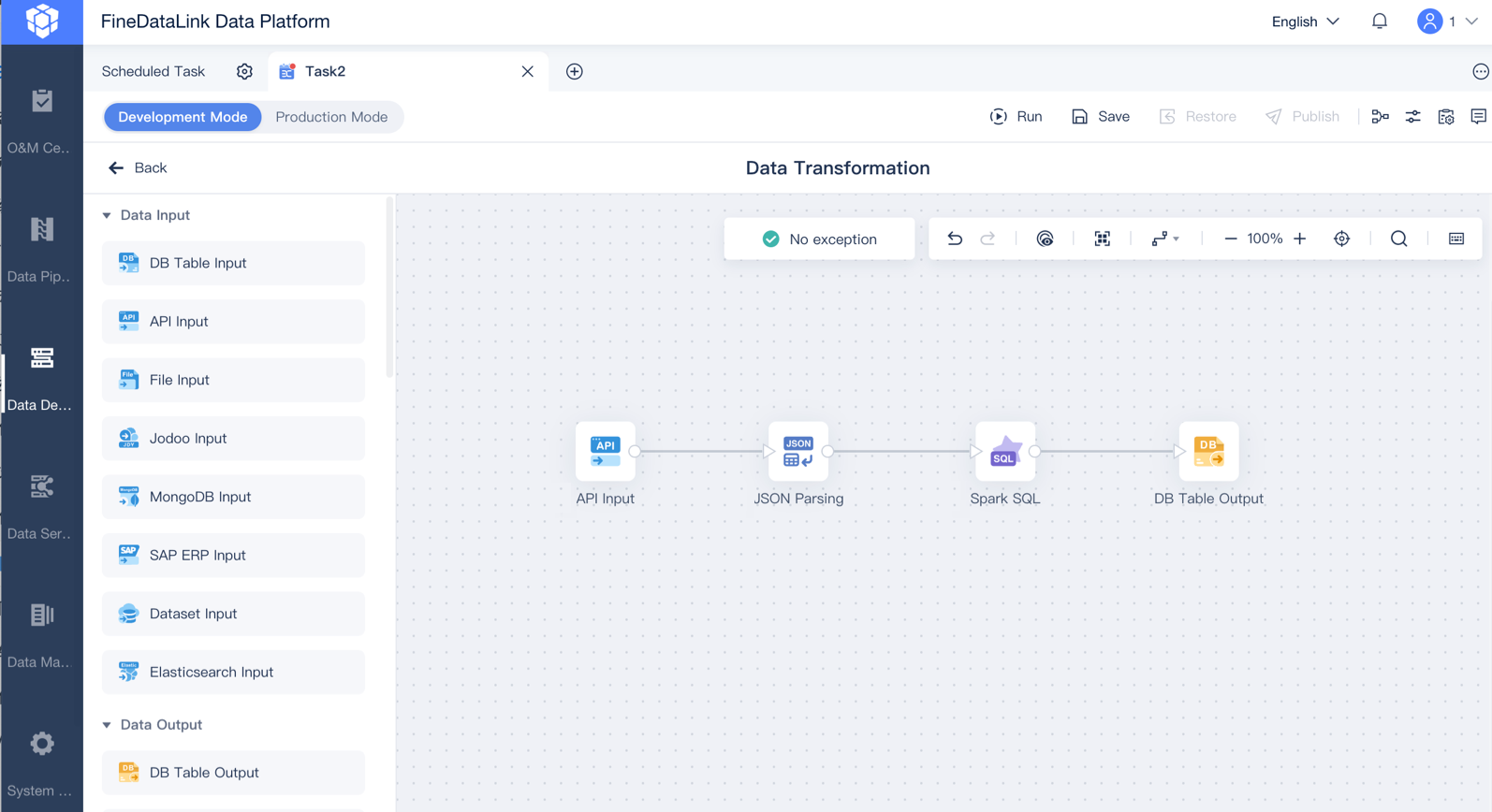

    The operators in the Data Transformation node belong to the data flow, but the Data Transformation node is a node in the step flow. Data flow focuses on processing each row and column of data during the flow of data from input to output, allowing for operations such as data input and transformation, as shown in the following figure.

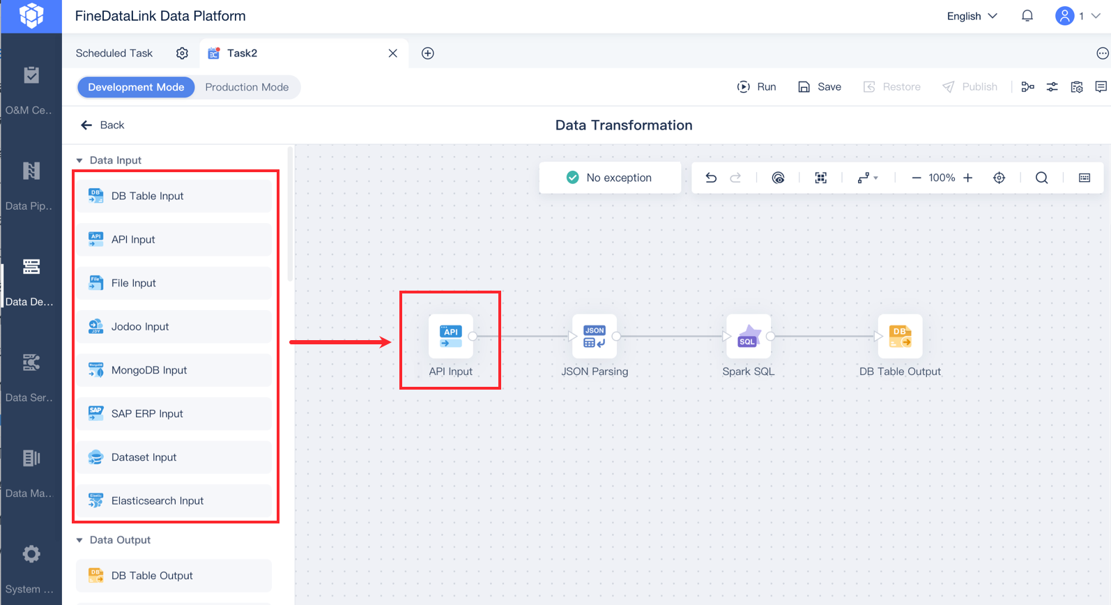

    Enter the Data Transformation node, drag the data input operator corresponding to the data source onto the canvas, and input the data, as shown in the following figure.

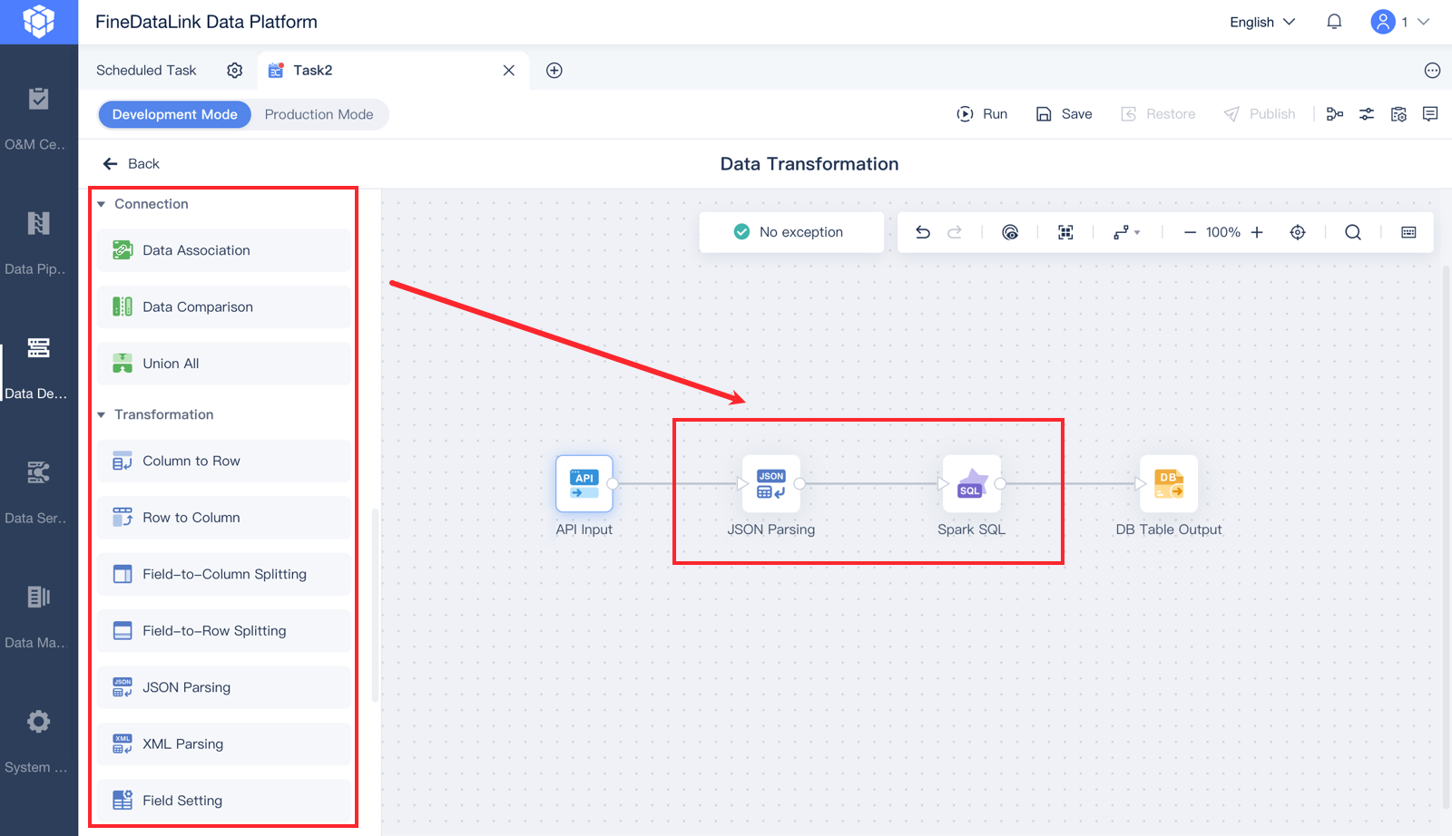

    Process the input data with operators in Connection and Transformation, as shown in the following figure.

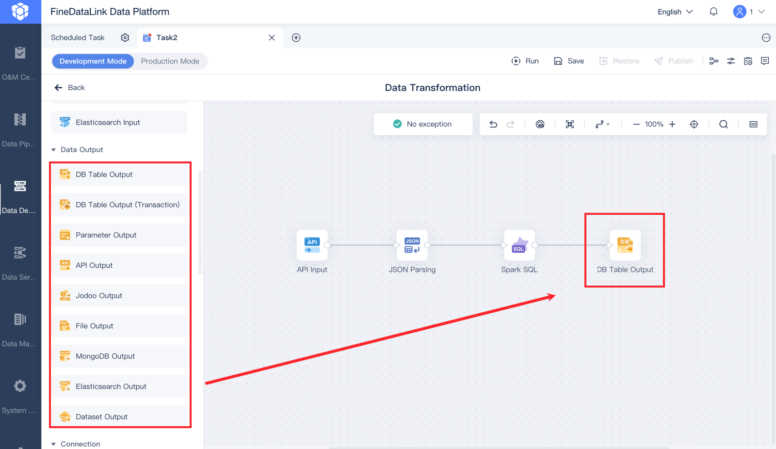

    Output the data after processing into the target database with operators in Data Output, as shown in the following figure.

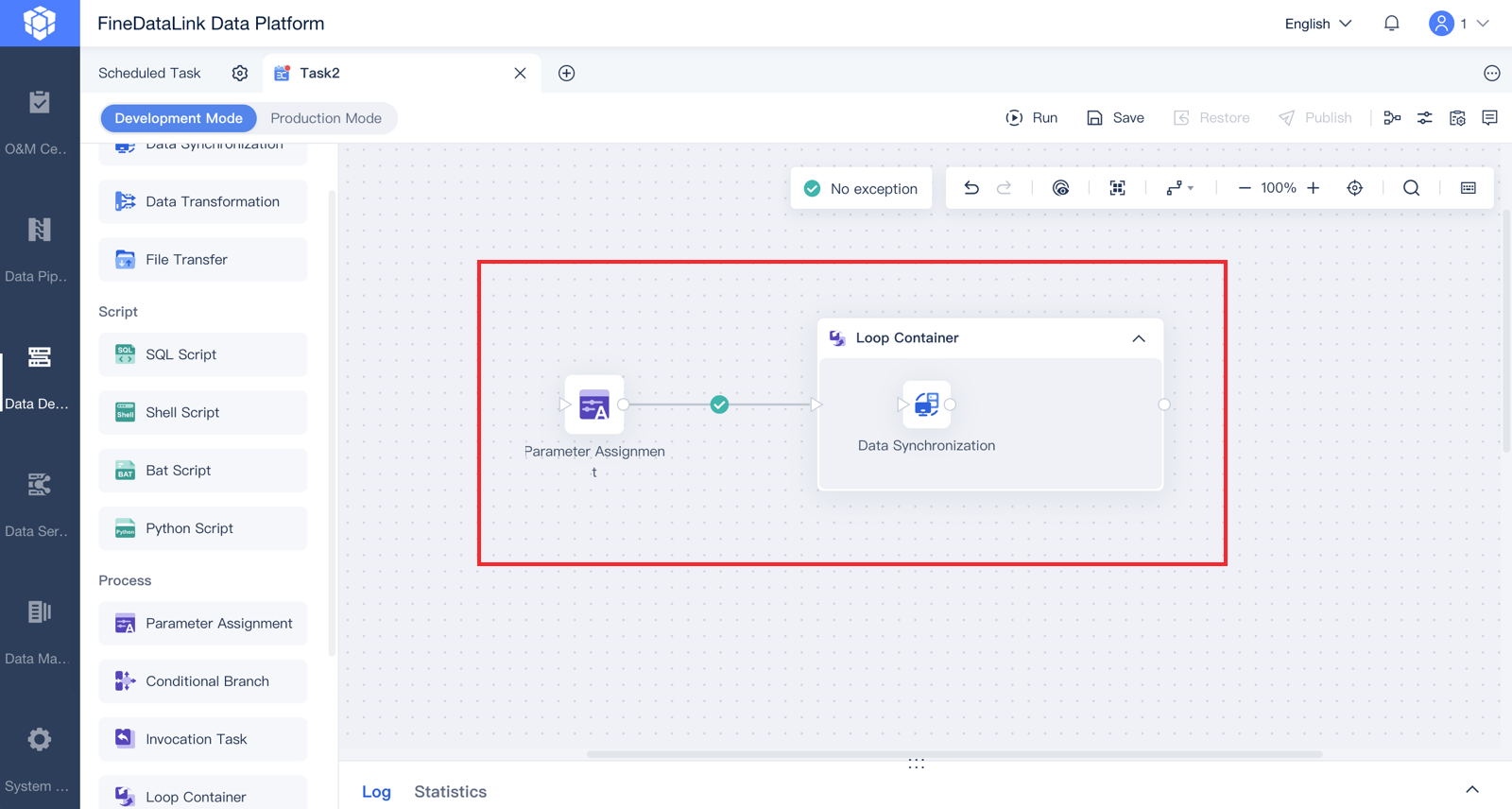

    The Data Synchronization node can be used with other step flow nodes (such as the Parameter Assignment node and the Loop Container node) to perform ETL data processing, as shown in the following figure.

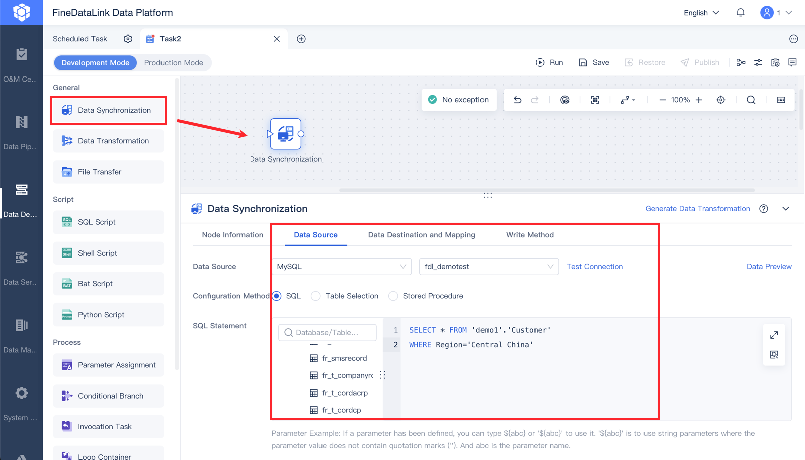

    You want to extract a large amount of data and synchronize the data directly into the target database without complex data processing.

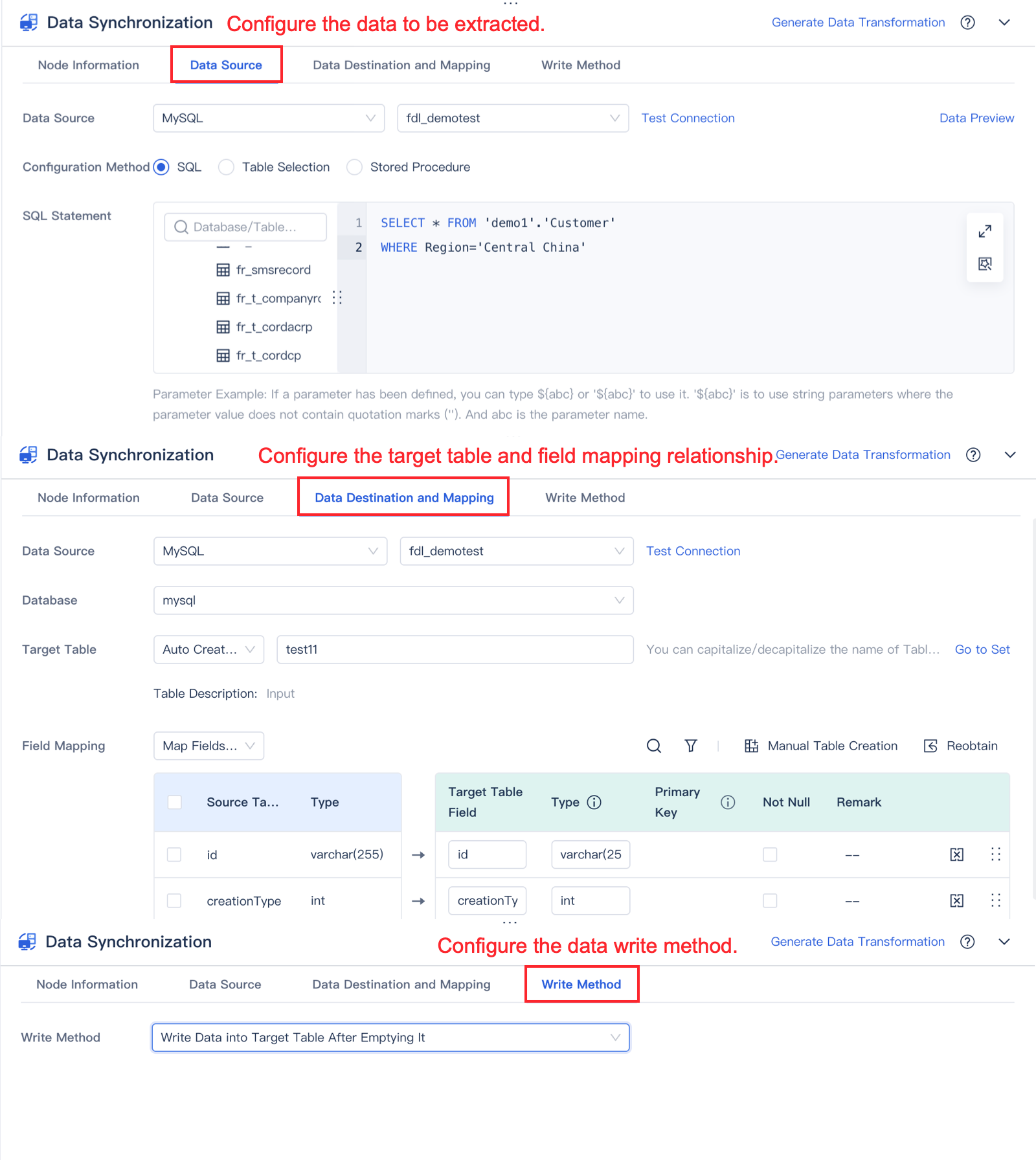

    Configure the data to be extracted in Data Source, the target table and field mapping relationship in Data Destination and Mapping, and the data write method in Write Method.
