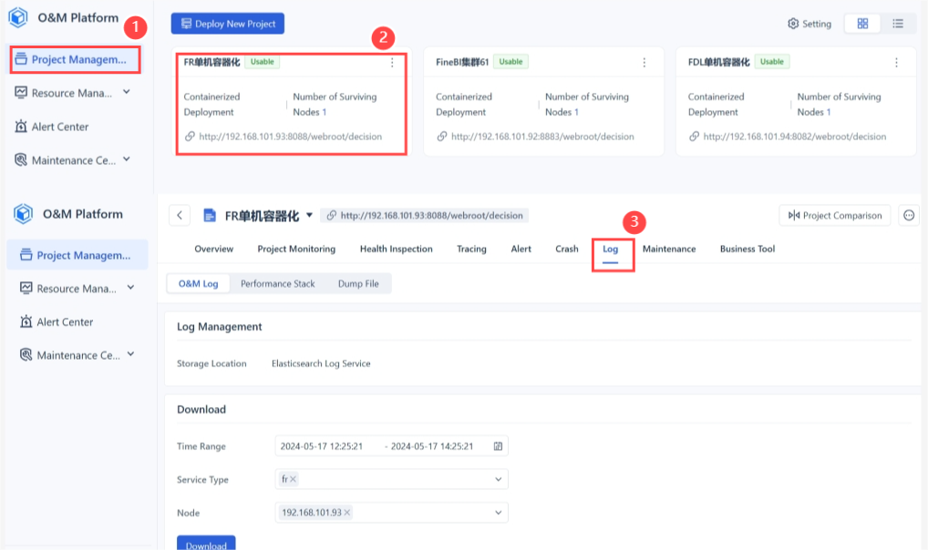

    Function Description
    FineOps provides a Log function for each O&M project.
    Index
    Function
    Index
    Description
    O&M Log
    Some companies have strict control over the data center and cumbersome application process
    for entrance, making log retrieval laborious.
    FineOps allows you to download the debugging log of the O&M project to the local.
