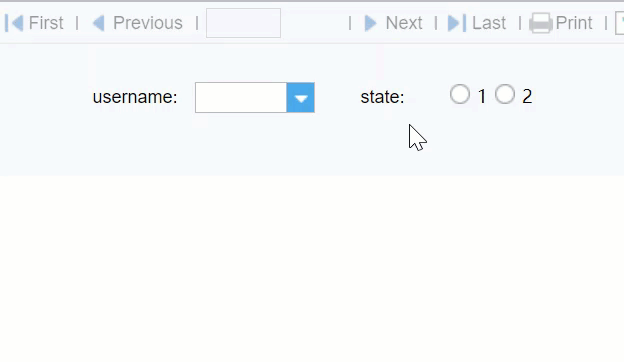

    After obtaining the widget on the parameter pane, assign it a value to realize the linkage of the widget value in the parameter pane:
    Click to download the template:
    Get the widget on the parameter pane.cpt

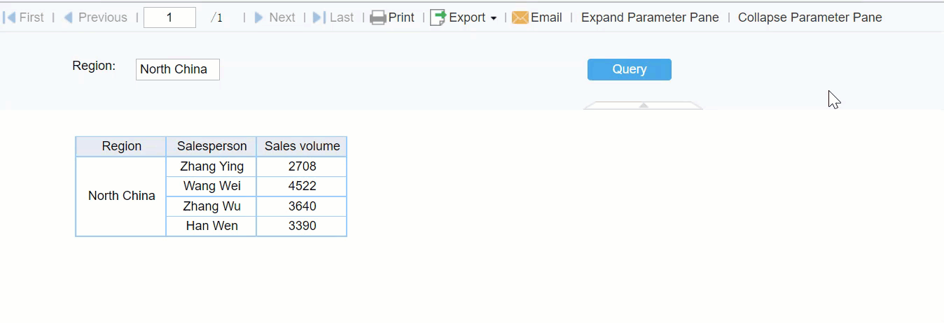

    Click the toolbar button to collapse the parameter pane:
    Customize toolbar buttons to control the expansion and collapse of the parameter pane.cpt

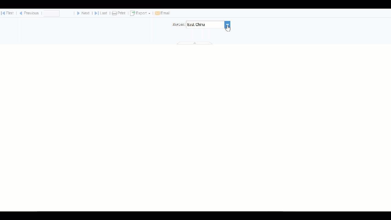

    After selecting the value from the drop-down box in the parameter pane, you can query without clicking the query button, as shown in the following figure:
    Automatic query after submitting.cpt
