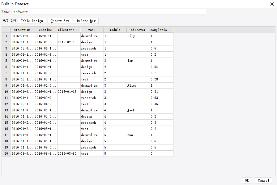

1. Data preparation
Create a new embedded  dataset software.

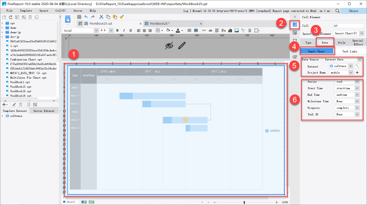

3. Data Binding
1) Bind Gantt chart data
  • Select [Dataset data] for [Data source], [software] for [Dataset], and [module] for [Project Name].
  • Select [task] for [Series], [start time] for [Start Time], [end time] for [End Time], [milestone time] for [Milestone Time], and [completion rate] for [Progress].
2) Bind task associated data
  • Click [Data]-[Gantt Chart].
  • Select [Dataset data] for [Data source] and [software] for [Dataset], and the data below need not to be set.

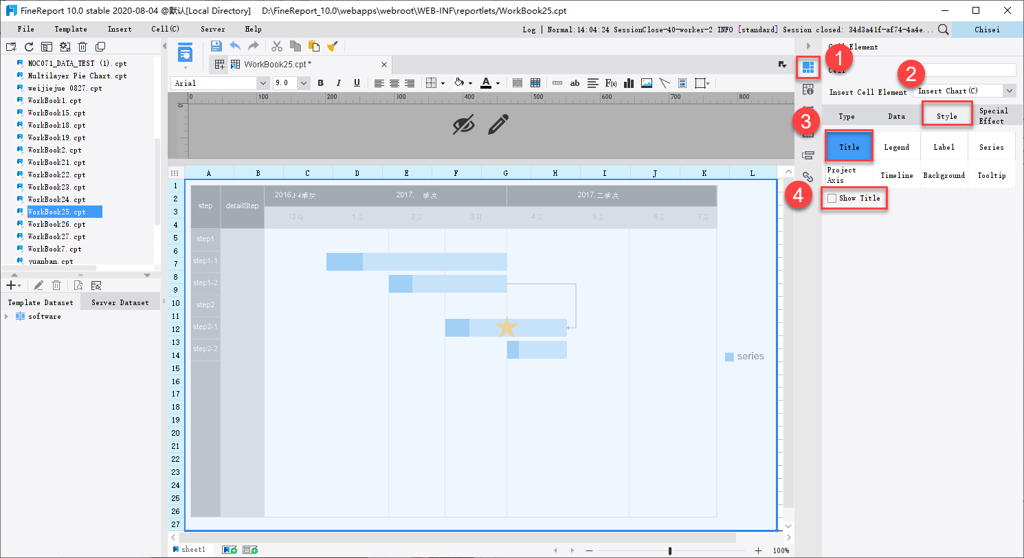

4. Style Setting
1) Delete the chart title
  • Remove the tick before [Show Title].

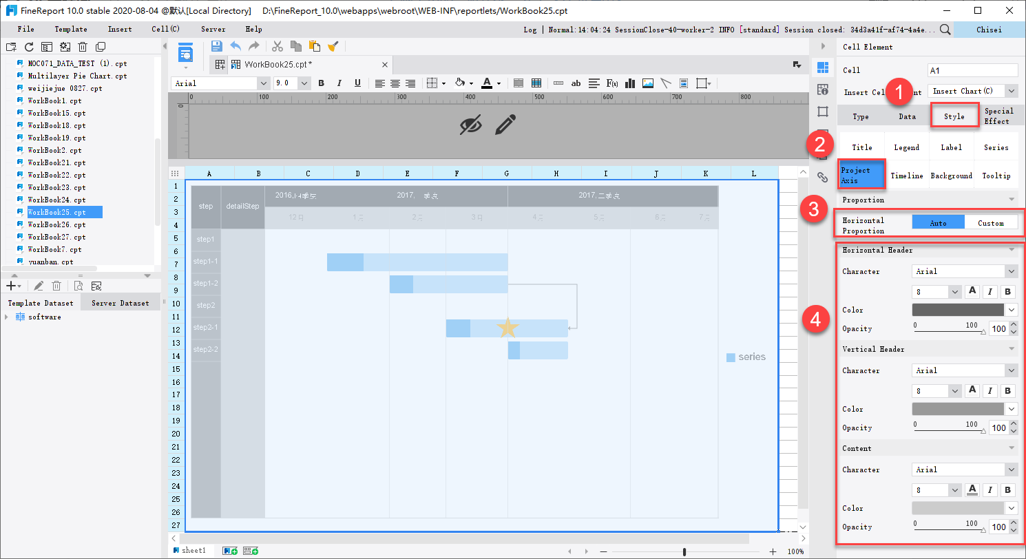

3) Set the project axis
  • Click the [Style] label.
  • Select [Project Axis].
  • Set [Proportion]-[Horizontal Proportion] to [Auto].
  • The specific settings of [Horizontal Header], [Vertical Header], and [Content] are shown below:

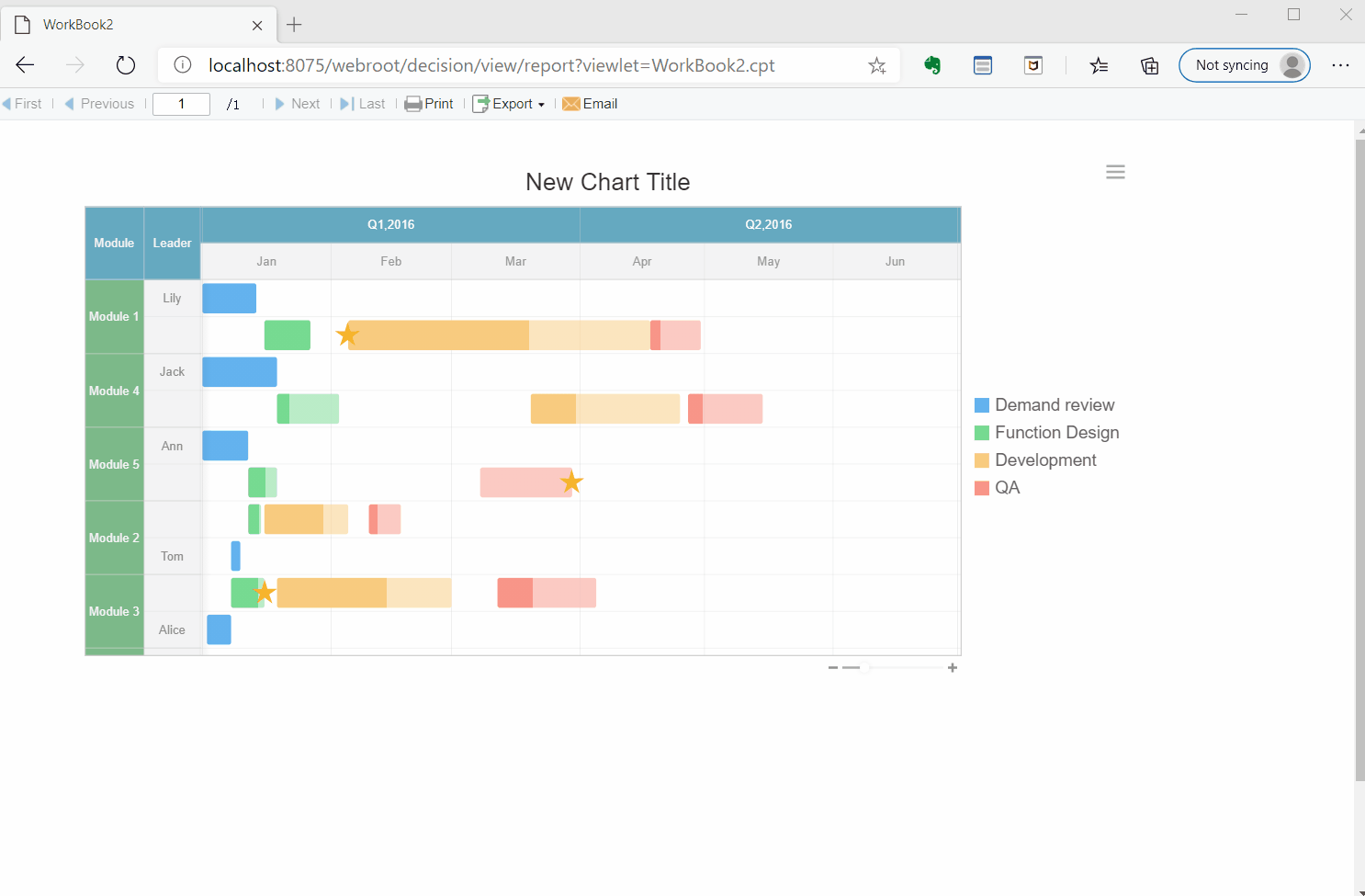

5. Preview
An example of a Gantt chart with style setting is as follows.
