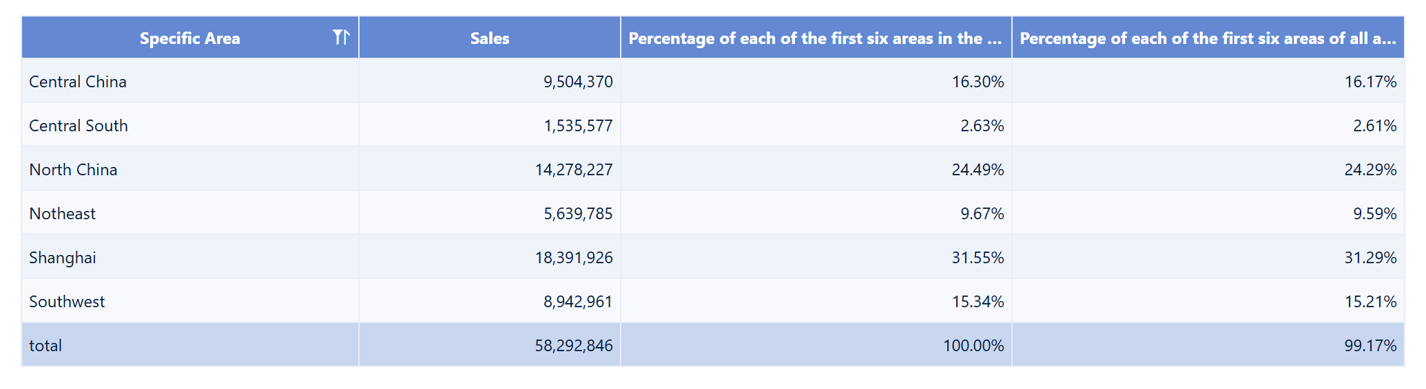

    You can calculate the percentage of sales of each of the top six areas in their total sales, as well as the percentage of sales of each of the top six areas in the total sales of all areas, as shown in the following figure.

    3. The following figure shows the result.

    Effect Display
    For details, see section "Expected Effect."
