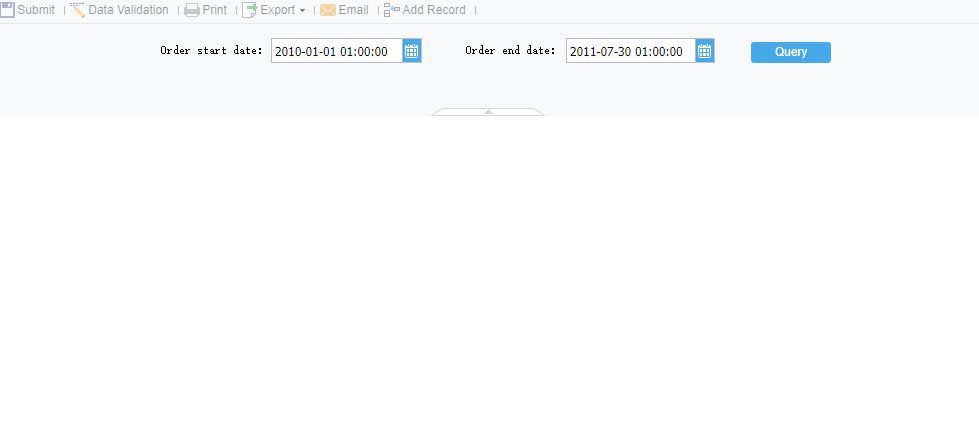

    Data validation can be partly done in the built-in parameter query interface. For example, there are two parameters: the start date and the end date, and we have to validate that:
    1. The start date and the end date must not be null and the end date must be after the start date
    2. The end date must fall within a certain period of time after the start date, or an alert will pop up
    To meet these requirements, we may add an event to the Query button. Specific settings are listed below.
    The desired effect is shown in the figure below:

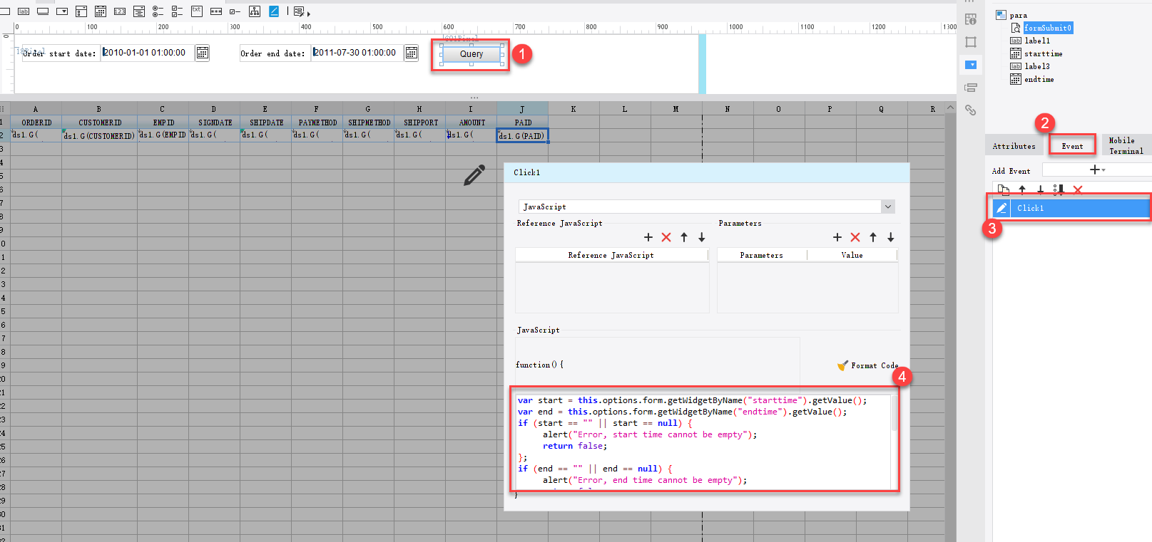

    2.1.1 Add an event to the Query button
    Click the Query button and add a Click event on the right-hand pane:
    Input the following JS codes:
    //Read the start date
    var start = this.options.form.getWidgetByName("starttime").getValue();
    //Read the end date
    var end = this.options.form.getWidgetByName("endtime").getValue();

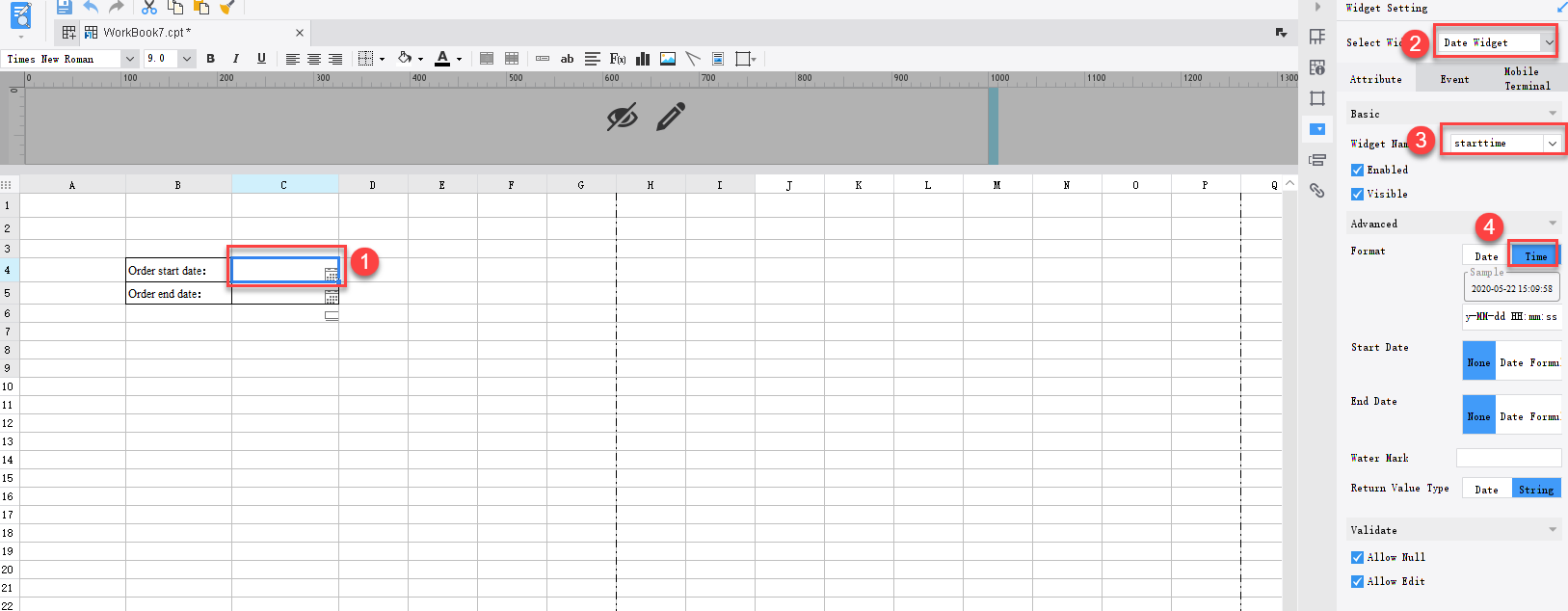

    2.2 Widgets for cell data entry
    If date widgets are used for cell data entry, add a date widget to a cell, set the name of the widget as starttime and change the format to Time:
    This also applies to the end date widget, but change the name of the end date widget to endtime.

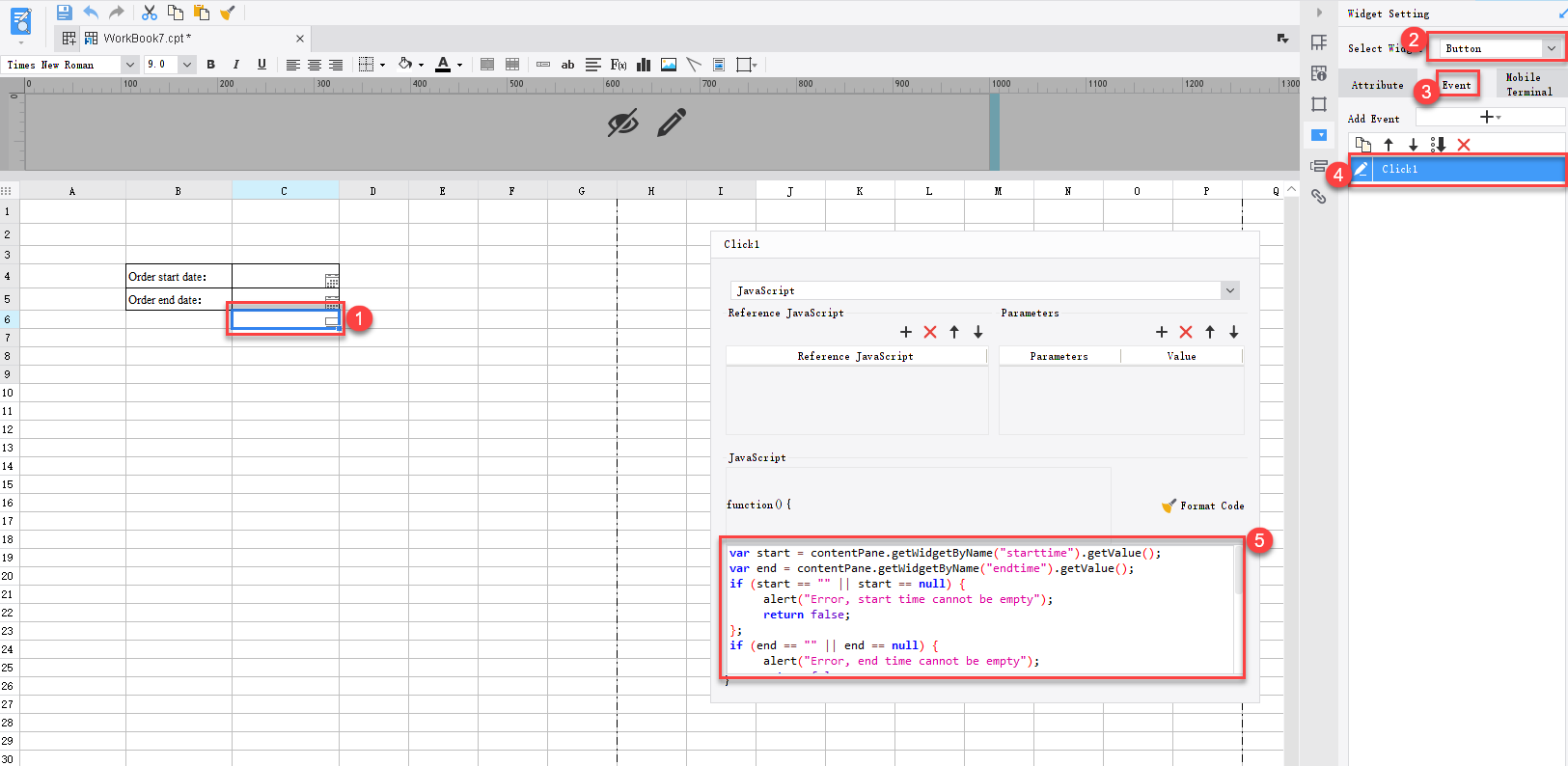

    Modify this.options.form.getWidgetByName("starttime") in the code as contentPane.getWidgetByName("starttime"), as shown below:
    var start = contentPane.getWidgetByName("starttime").getValue();
    var end = contentPane.getWidgetByName("endtime").getValue();

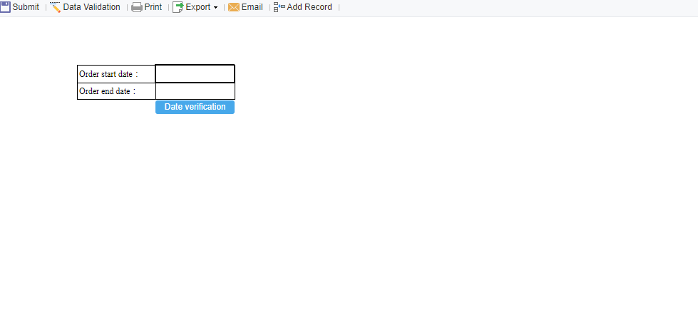

    View the effect:
