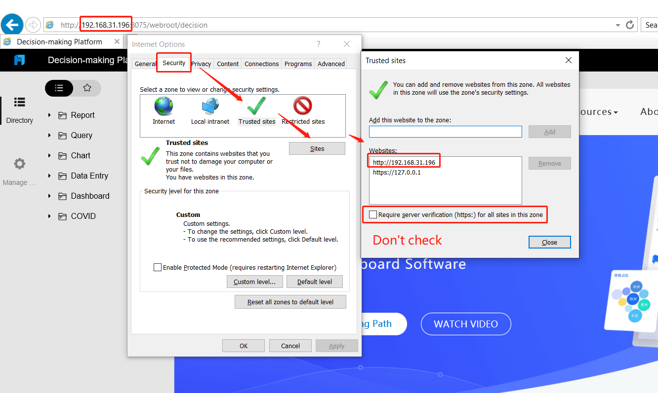

    In addition, Internet explorer needs to add the address of the report server to the trusted site, as shown below:
