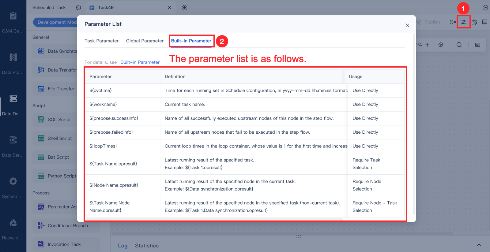

    The following figure shows the currently available built-in parameters.
    Built-in ParameterScope of EffectUsageDefinitionParameter Type
    ${cyctime}
    In the Current Task
    Use Directly
    The parameter refers to the time for each running of the ETL task set in Task Control, in yyyy-mm-dd hh:mm:ss format.
    For example, 2021-09-09 20:45:50 (accurate to the second).
    The time here represents the time when the task enters the running queue, not the actual execution time, which occurs slightly later.
    When you need to perform some operations with the task running time, you can use the built-in parameter ${cyctime}.
    For example, if a task runs every 30 days, you only need to update the data of 30 days before the running time point (${cyctime}).
    Date
    ${workname.opresult}
    In All Tasks
    Require Task Selection
    The parameter refers to the latest running result of the specified task. For example, ${Task 1.opresult} can output three values:
    • success: The task run successfully.
    • error: Errors occurred in the task running process. (In versions before V4.0.3, this value is fail.)
    • invalid: The task was aborted. (Task exception, which is usually caused by the shutdown of FineDataLink during task execution, and the task status will be set to invalid after restart.)
    This parameter is usually used to set the judgement condition for the conditional branch nodes.
    String
    ${jobname.opresult}
    In the Current Task
    Require Node Selection
    The parameter refers to the latest running result of the specified node in the current task. For example, ${Data Synchronization.opresult} can output three values:
    • success: The node run successfully.
    • fail: The node failed to run.
    • skipped (added in V4.0.3): The node skipped execution.
    String
    ${prepose.successInfo}
    In the Current Task
    Use Directly
    The parameter refers to the name (array string) of all successfully executed upstream nodes of this node in the step flow.
    For example, [[SQL Script], [Data Transformation]]
    String
    ${prepose.failedInfo}
    In the Current Task
    Use Directly
    The parameter refers to the name (array string) of all upstream nodes that fail to be executed in the step flow.
    String
    ${loopTimes}
    In the Loop Container
    Use Directly
    The parameter refers to the current loop times in the loop container, whose value is 1 for the first time and increases by 1 with each loop.
    INT
    ${workname.jobname.opresult}
    The parameter refers to the nodes with management authority for tasks (except for the current task, which requires the parameter ${jobname.opresult}.)
    Require Node + Task Selection
    The parameter refers to the latest running result of the specified node in the specified task (non-current task). For example, ${Task 1.Data Synchronization.opresult} can output three values:
    • skipped: The node skipped execution.
    String
    ${workname}
    In the Current Task
    Use Directly
    The parameter refers to the current task name.
    String

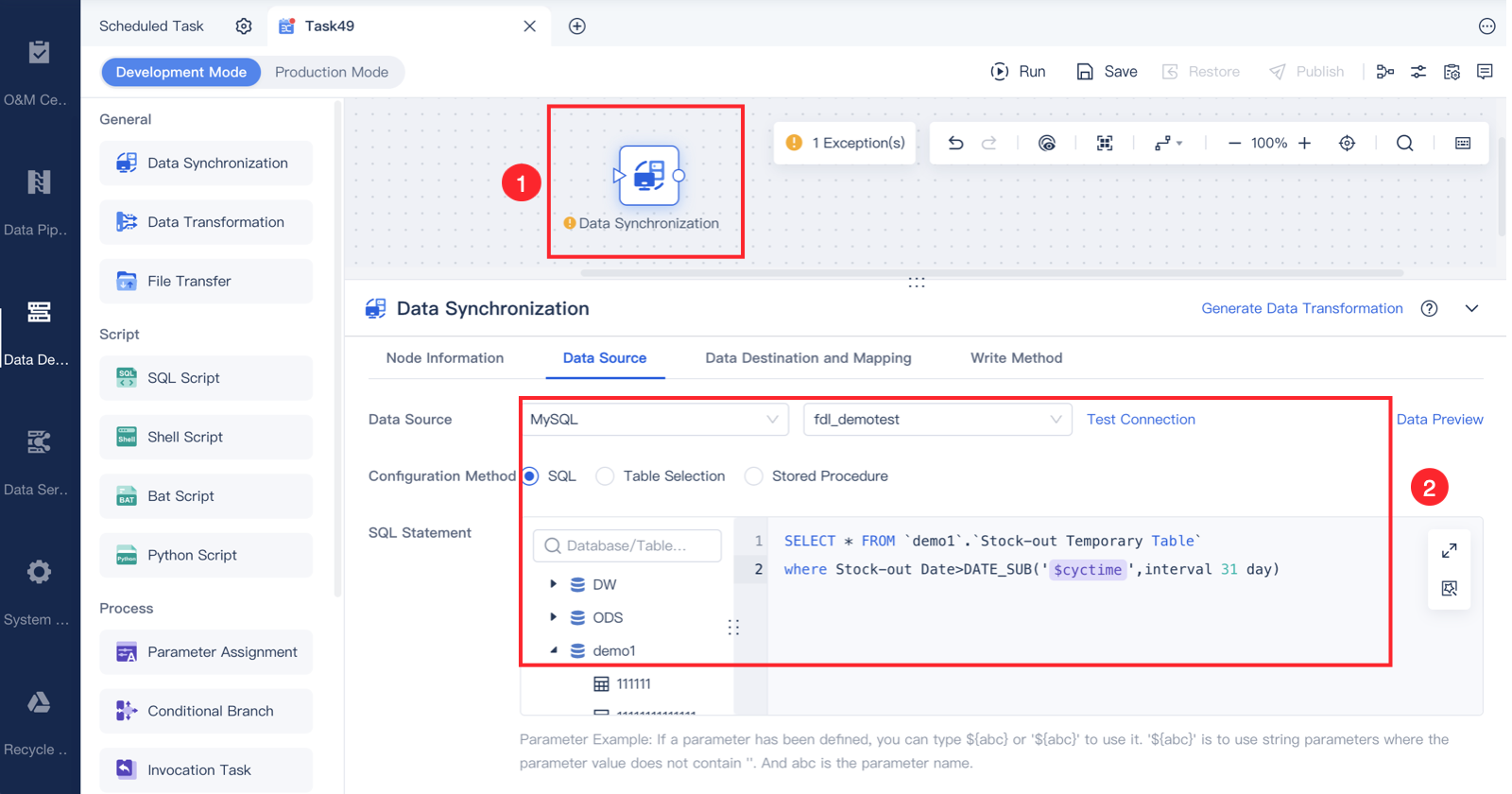

    Example: The instance is triggered and generated by Task Schedule.
    With the built-in parameter ${cyctime}, you can synchronize only the data of 31 days before the running time point each time the task runs.

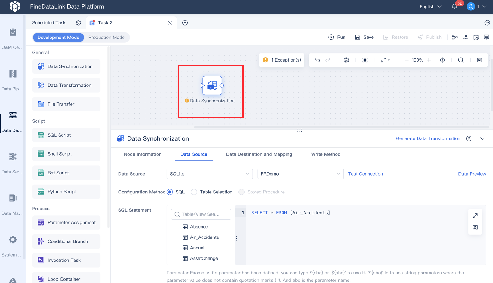

    1. Create a scheduled task and drag the Data Synchronization node onto the page.
    2. Set the data source for the node as shown in the following figure. The SQL statement is used to retrieve the data of the previous 31 days from the Stock-out Temporary Table.
    The SQL statement is as follows:
    SELECT * FROM `demo1`.`Stock-out Temporary Table` where Stock-out Date>DATE_SUB('${cyctime}',interval 31 day)
    Click Data Preview, the retrieved data is from the 31 days before the current system time.

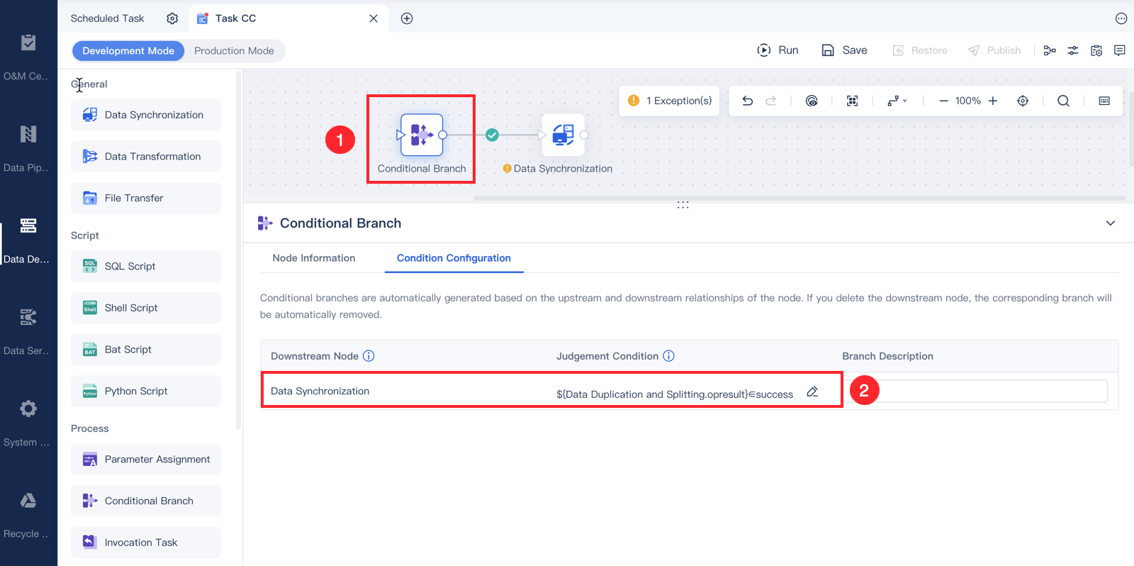

    ${workname.opresult}——Conditional Branch Node Judgement
    The built-in parameter ${workname.opresult} is usually used to set the judgement condition for the conditional branch nodes.
    Example: Task CC is executed after the scheduled task Data Duplication and Splitting is executed successfully.
    iconNote:
    In V4.0.30 and later versions, this scenario can be implemented through Event Schedule.

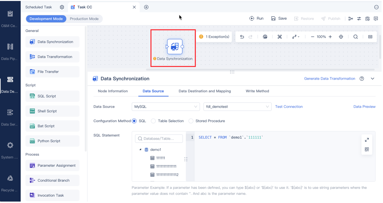

    1. Task CC contains a Data Synchronization node, which implements cross-database synchronization, as shown in the following figure.

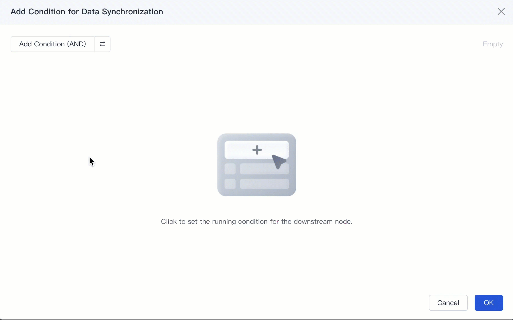

    2. To make Task CC to be executed after the scheduled task Data Duplication and Splitting is successfully executed, you can use the built-in parameter ${workname.opresult}.

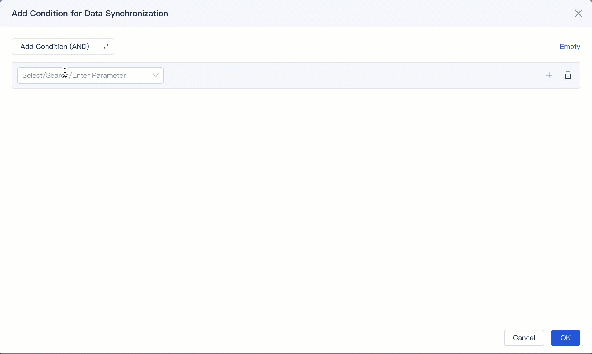

    Drag the Conditional Branch node in front of the Data Synchronization node, and set the judgment condition in the Conditional Branch node as: ${Data Duplication and Splitting.opresult} is success.
    iconNote:
    In V4.1.0 and later versions, you need to select the task when using this parameter in the Conditional Branch node, as shown in the following figure.
    In versions earlier than V4.1.0, when using this parameter in the Conditional Branch node, you can directly input Data Duplication and Splitting.opresult in the parameter column and press the Enter Key, and input success in the text box on the right.

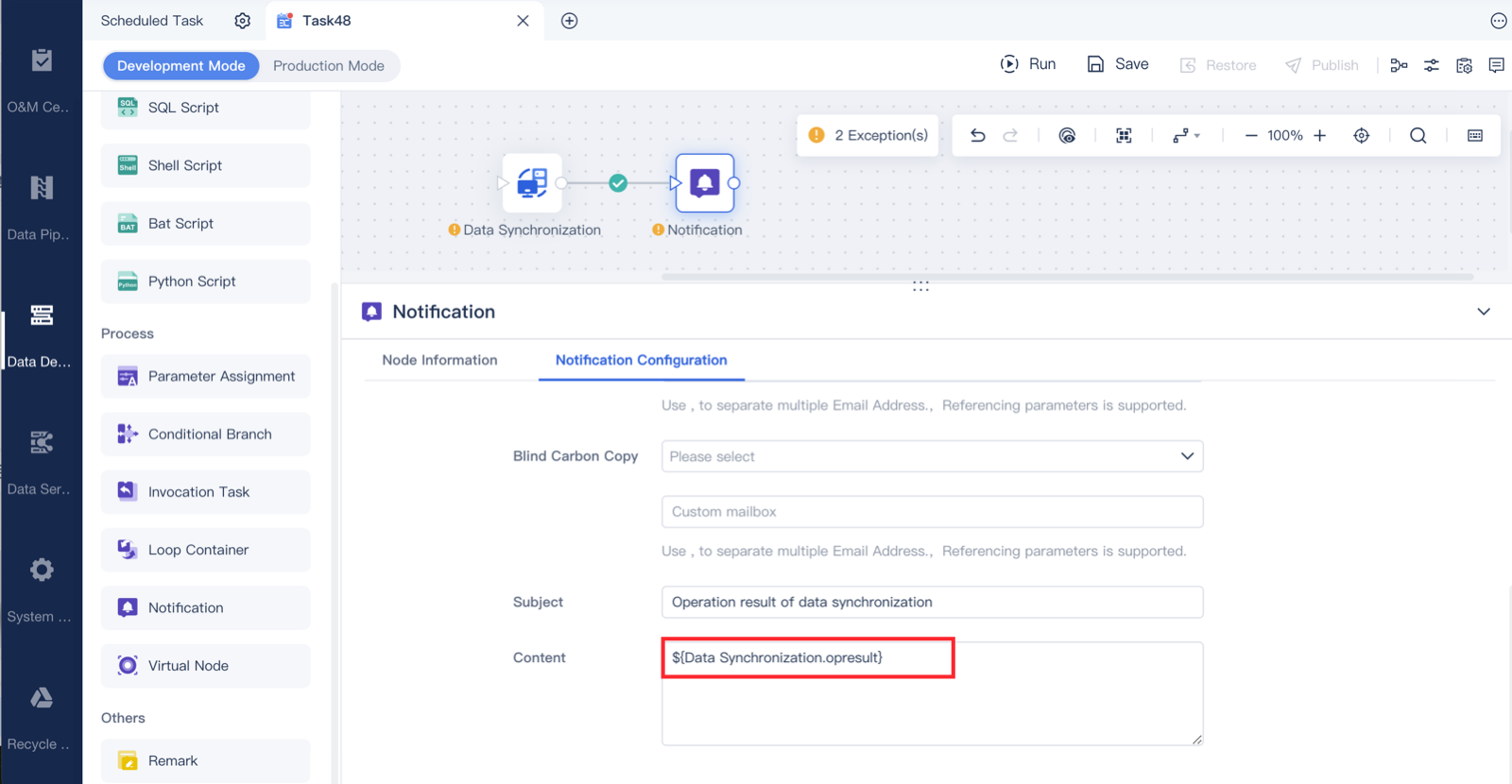

    ${jobname.opresult} — Running Result of the Specified Node in the Current Task
    iconNote:
    The parameter format is ${Upstream Node Name.opresult}.
    1. Modify the message content of the Notification node to ${Data Synchronization.opresult}, as shown in the following figure.
    2. After the Data Synchronization node is executed successfully, you will receive a success message.

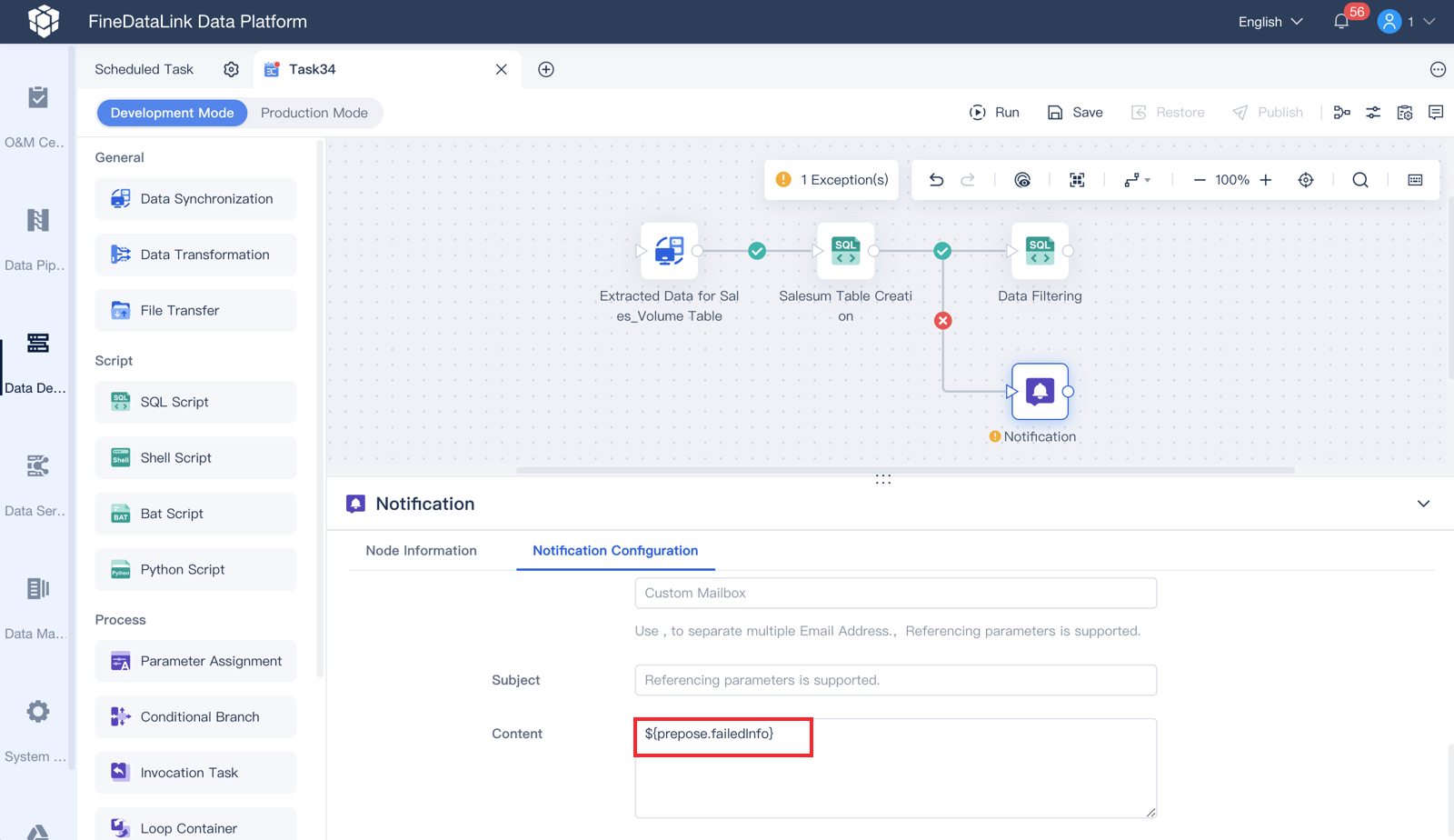

    ${prepose.failedInfo} — Name of the Nodes that Fail to be Executed in the Upstream
    1. Modify the message content of the Notification node to ${prepose.failedInfo} by referring to the "${prepose.successInfo} — Names of the Successfully Executed Nodes in the Upstream" section in this document.
    2. After the task is executed, you will receive a message with all names of the upstream nodes of the Notification node that fail to be executed.

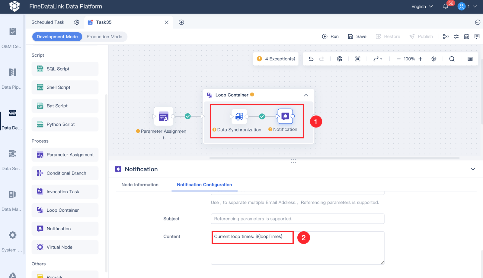

    ${loopTimes} — Current Loop Times in the Loop Container
    This parameter takes effect within the loop container, which refers to the current loop times in the loop container, whose value is 1 for the first time and increases by 1 for each subsequent loop.
    1. Drag the Notification node into the Loop Container node. The following figure shows the setting page.
    2. After the task is executed, you will receive the current loop times.

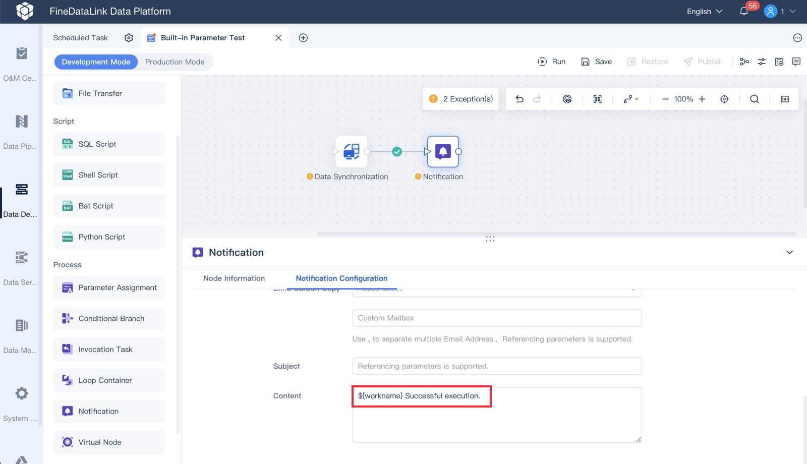

    Example: Use this parameter in the Notification node to notify users that the task is successfully executed.
    1. The Built-in Parameter Test Task contains a Data Synchronization node and a Notification node.
    2. The following figure shows the setting page of the Notification node.
    3. After the task is successfully executed, you will receive the execution result of the task.
