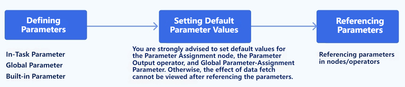

    Step One: Defining Parameters (Mandatory)
    The parameters on FineDataLink are divided into three types: in-task parameter, global parameter, and built-in parameter, as shown in the following figure.

    Step Two: Configuring Default Parameter Values (Recommended)
    Description
    You are advised to configure default and valid (can be previewed) parameter values for the parameters in the Parameter Assignment node, the Parameter Output operator, and Global Parameter - Static Parametermentioned in chapter "Step One: Defining Parameters (Mandatory)," as shown in the following figure.
    iconNote:
    1. The default parameter values serve only to facilitate data preview in downstream nodes and do not participate in the actual execution.
    2. If the closure character is enabled, the parameter value will be enclosed by single quotes (''). If the subsequent node references the parameter, pay attention to the use of single quotes ('')/double quotes (""). Adding an additional layer of single quotes ('') or double quotes ("") may result in data retrieval failure. For example, the value of parameter a is 'Beijing', referencing this parameter with an additional single quote ('${a}') will change the parameter value to ''Beijing'', as shown in the following figure.
    Configuring default parameter values facilitates the use of parameters in subsequent nodes, allows for viewing the effects of parameter references, and helps you confirm whether the task settings are correct.
