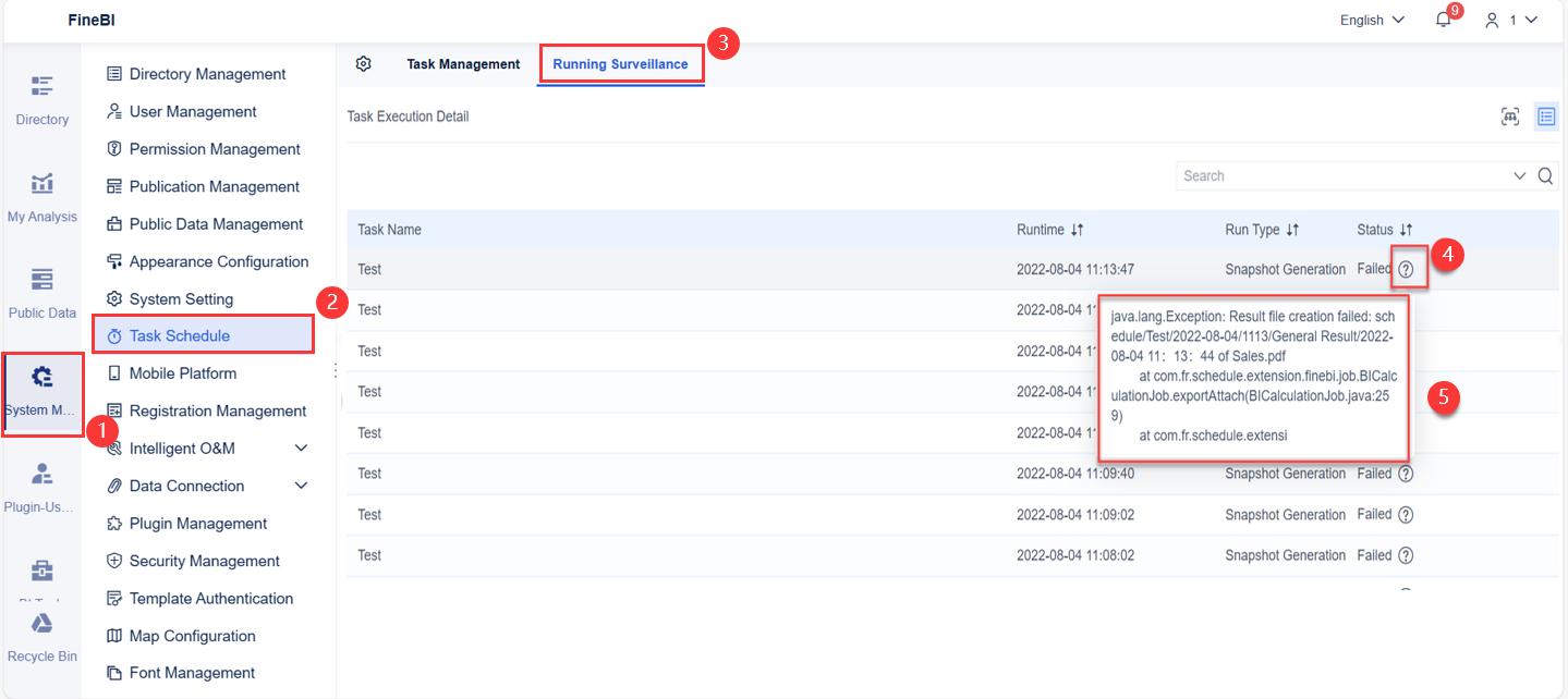

    When a scheduled task fails to execute, there is a  on the right side of the corresponding log in Task Execution Detail of Running Surveillance. The corresponding error is displayed when you click.
    This document introduces some errors and solutions in scheduled tasks.
    Attachment Generation Failure Due to Too Long File Name
    Error:
    Result file creation failed: Attachment name
    This error will cause the loss of the error attachment or the size of the attachment sent being 0 KB when you process subsequent attachment tasks (like sending emails).
