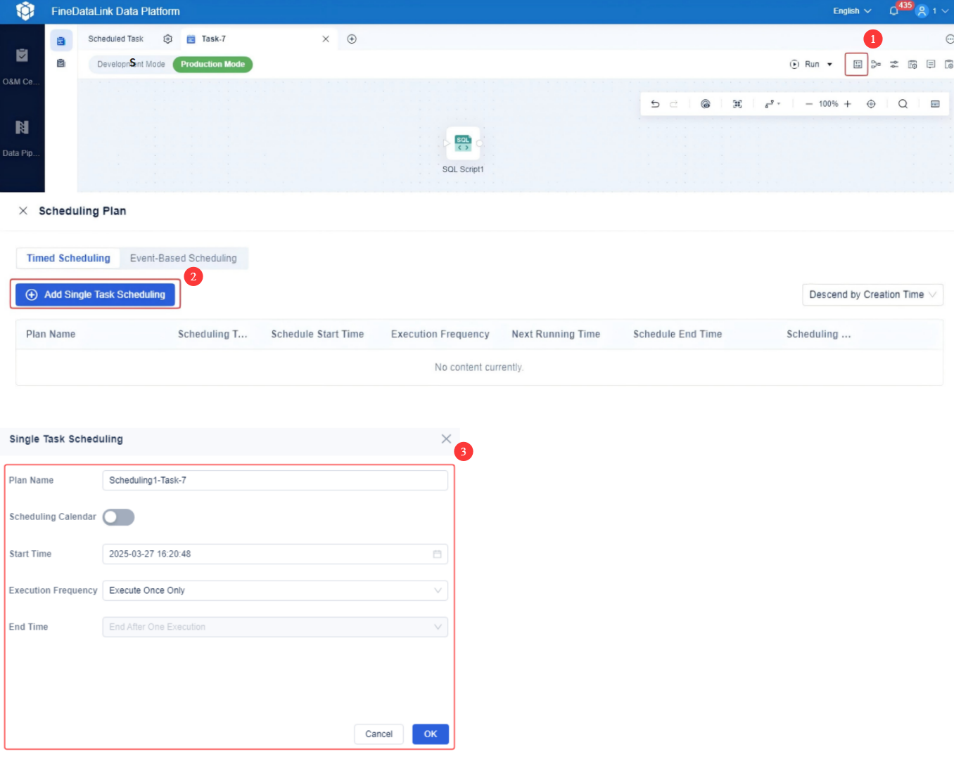

    Procedure
    For example, you may want the scheduled task to be executed once every day to ensure smooth task operation.
    Enter the scheduled task editing page and click the QQ浏览器截图20250402160307.pngicon in Production Mode to add a single scheduling plan, as shown in the following figure.
    Set Plan Name and Start Time. Set Execution Frequency to Execute Repeatedly, and set End Time to Unlimited so that the current task will be executed at the same time every day, as shown in the following figure.
