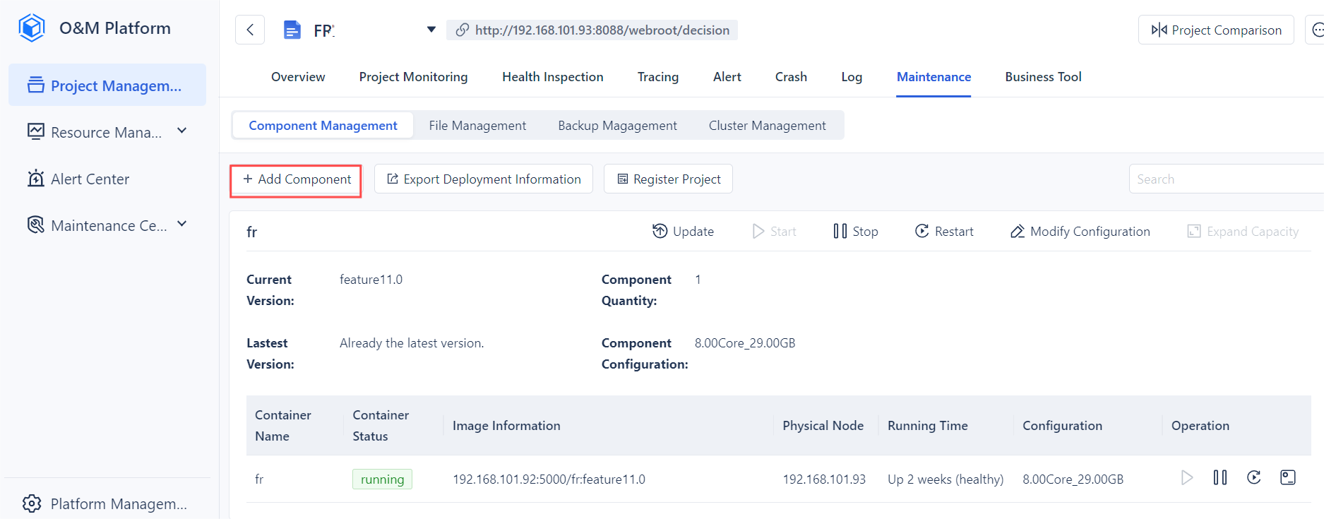

    1. Log in to FineOps as an admin, select the target project, choose Maintenance > Component Management, and click Add Component.
    If Add Component is not displayed, the project deployment method does not meet the requirement or no components need to be added.
