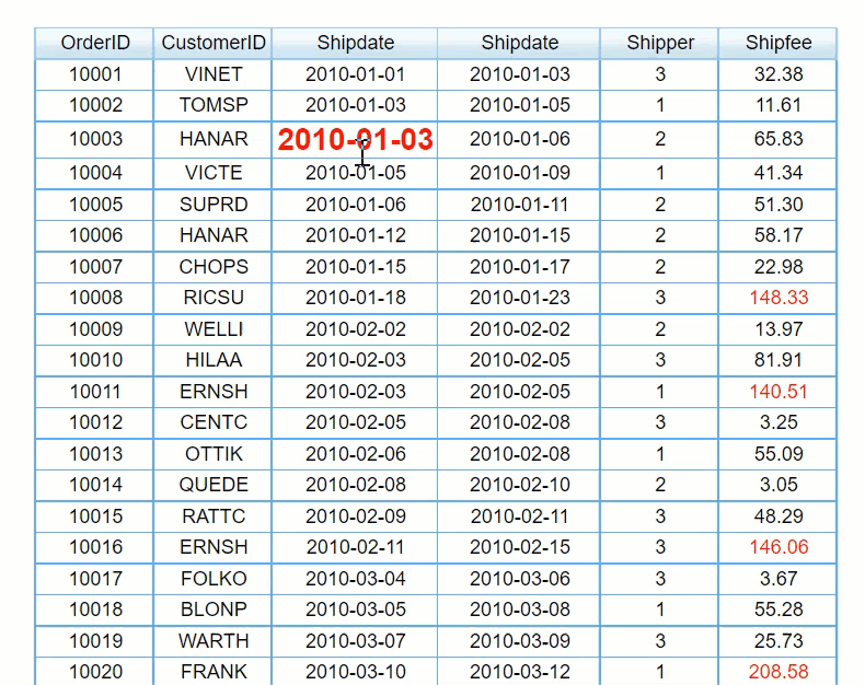

    When the mouse hovers over the cell, the font is displayed in red and bold 14, and it is restored when you leave:

    Example 1: If the obtained report block object is defined as report , the font will be displayed in red and bold 14 when the mouse is hovered, and it will be restored when left.
    report.addEffect('setCellFont', {
    style: {
    bold: true,
    fontSize: 14,
    color: 'red'
    trigger: 'mouseover',
    single: true
