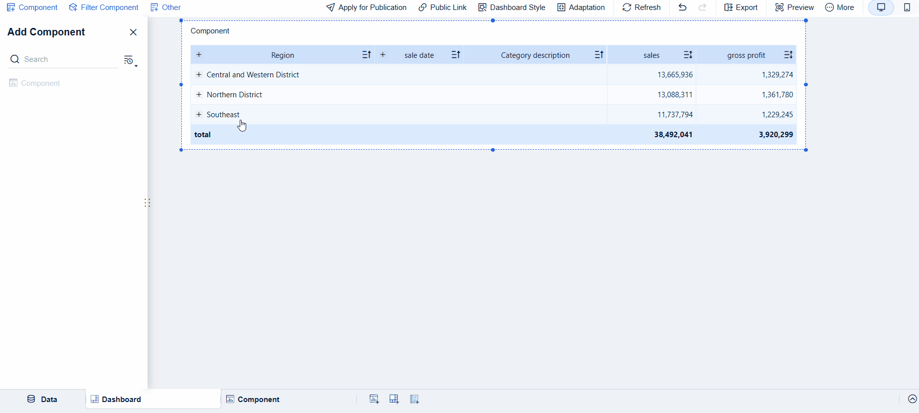

    1. Use the data ENdemo_Pareto_Data_Analysis to create a table component, as shown in the following figure.
