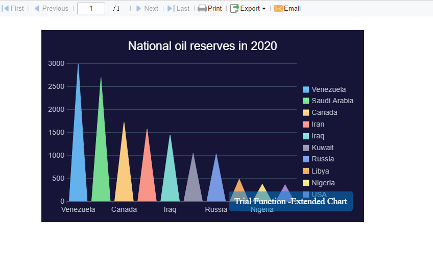

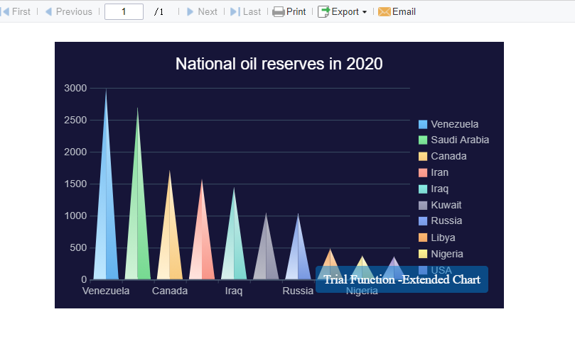

    A new subtype is added to the Column in version 4.3 of the Extended Chart plugin: Non-traditional Column Chart.
    Users can use this chart to customize the shape of a column chart. It is a variant of a column chart. Compared with ordinary column chart, it is more artistic and suitable for big screen display. The effect is shown below:

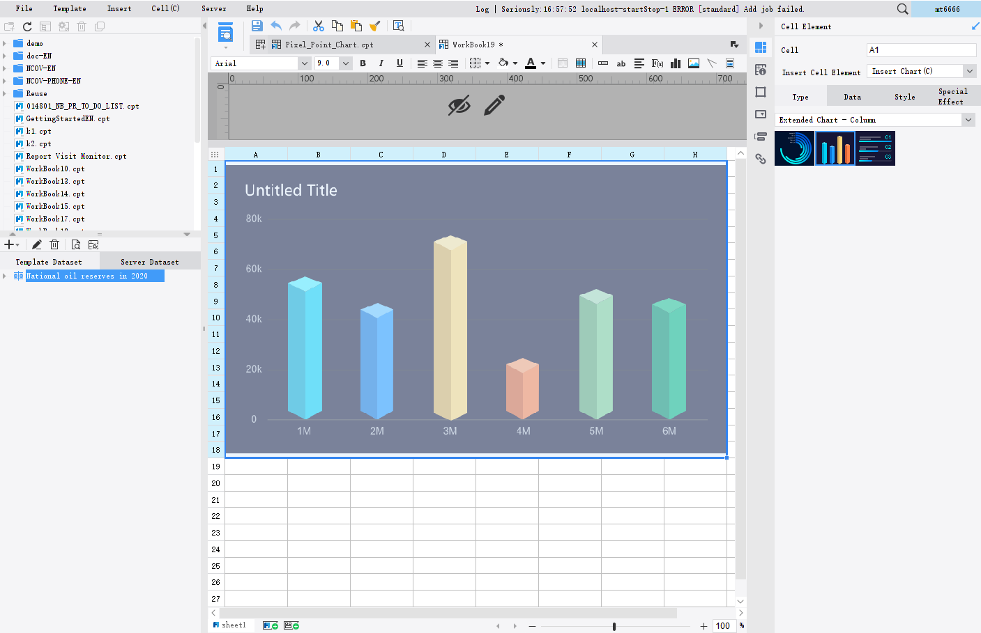

    5. Chart entry
    In the Chart Type, added a Non-traditional Column Chart under the Extended Chart - Column, which can be optionally inserted into the report.

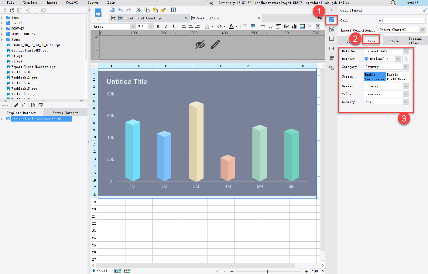

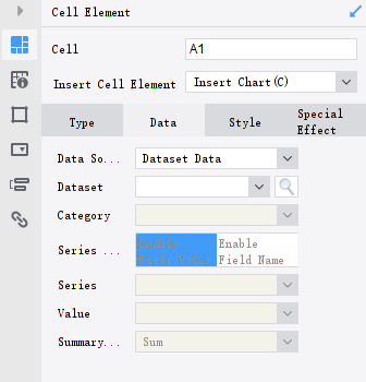

    1. Data
    Except that it does not support multiple categories and data filtering, it is consistent with the column chart, as shown below:

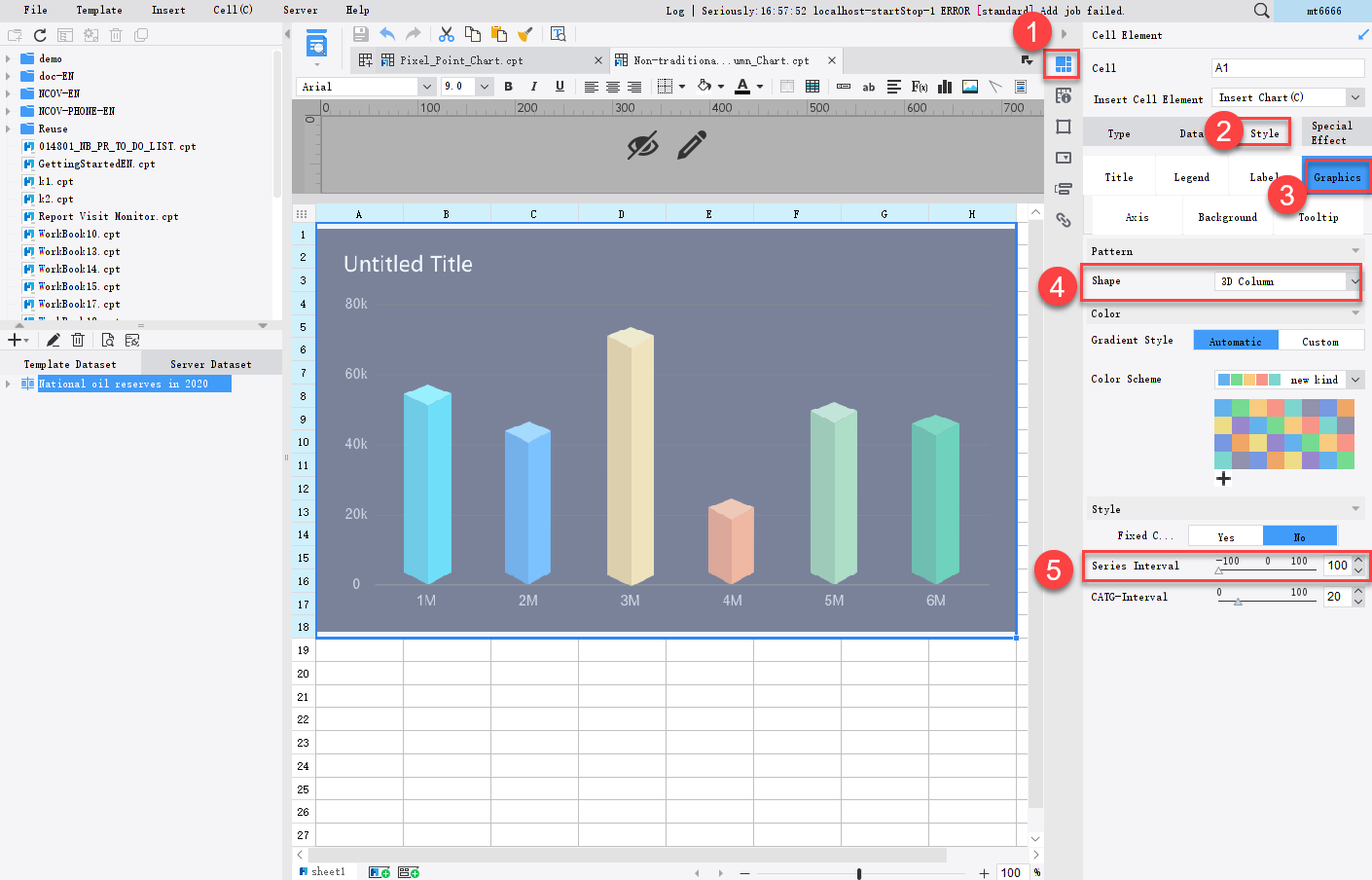

    2. Style

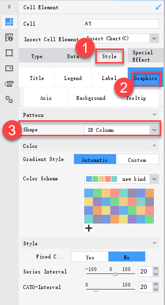

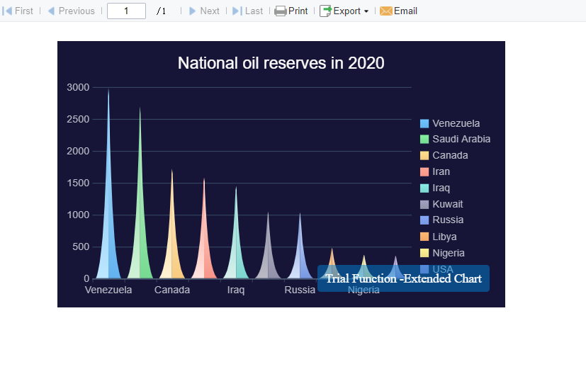

    Custom shapes can be set under Style > Graphics > Shape. There are 5 built-in shapes: Triangle, 3D Triangle, Curve, 3D Curve and 3D Column.

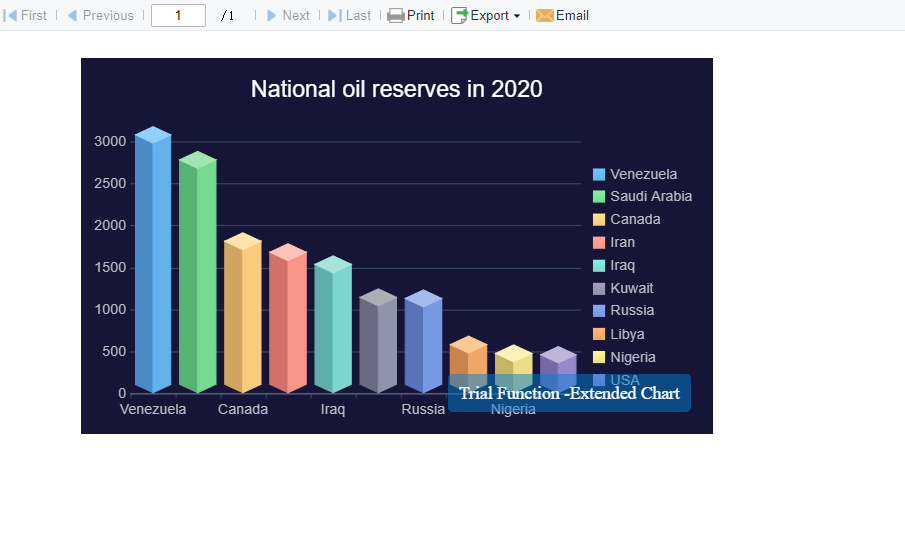

    The effect of each shape is as follows:
    • Triangle
    • 3D Triangle
    • Curve
    • 3D Curve
    • 3D Column

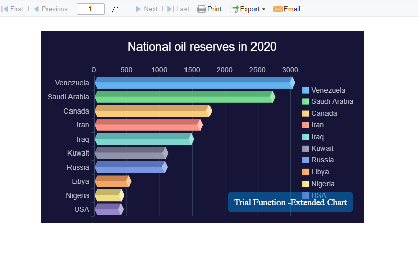

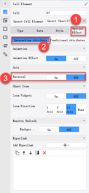

    3. Special effect
    After Reversal is enabled under the Interaction Attribute, the column chart effect can be changed.
    The effect is as shown below:

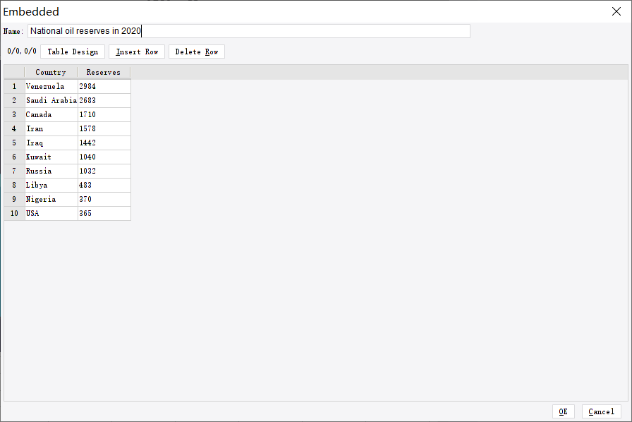

    1. Data preparation
    Create a general report and a built-in dataset. The data is as follows:
    2. Insert the chart
    Merge a region cell and insert an non-traditional column chart, as shown below:
    3. Bind the data
    Bind chart data, as shown below:
    Note: The category and series name are set in order to make each column color is different.
    4. Set the style
    Set the shape to 3D Column and the Series Interval to -100, as shown below:

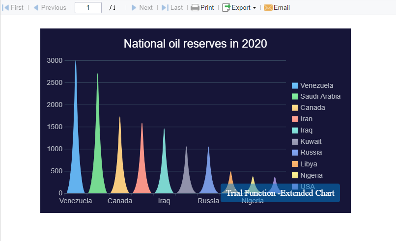

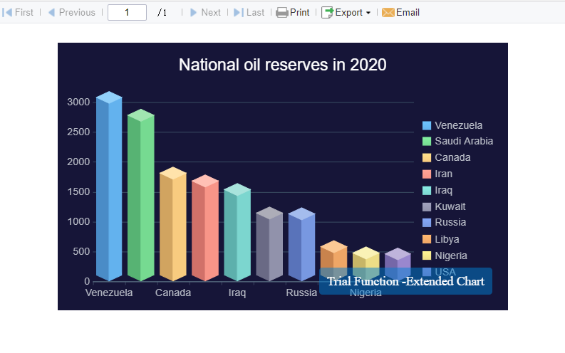

    5. Preview effect
    Save the report, and click "Pagination Preview", the effect is as shown below:
    Note: The mobile terminal is not supported.
