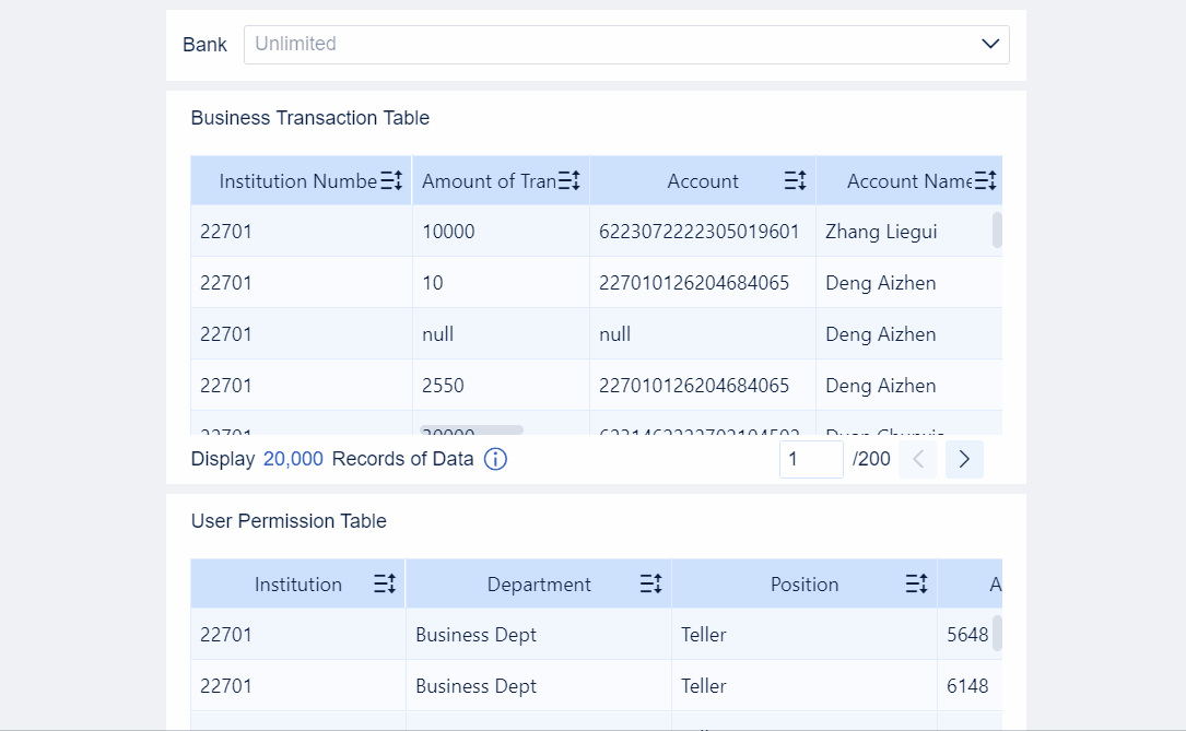

    Filter Component Adding
    Add a dashboard, drag the two prepared detail tables to the dashboard, adjust the components, add a Drop-down Tree Filter Component, click Institution Table in All Fields, drag the relevant fields to Field, and rename Drop-Down Tree to Bank, as shown in the following figure.
    Click OK. You can view the hierarchical relationship between the headquarter, branch offices, and sub-branch offices and filter the needed data.
    iconNote:
    Blank nodes store data that has not been grouped in the parent node.
    Effect Display
    The effect is same with section "Application Scenario."
